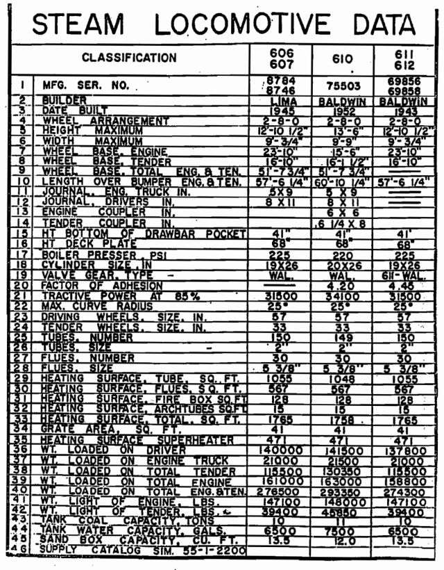

Dick, Thanks for the information on the S-160s and the lead on the movement of the three engines from Camp Claiborne to the Alaska Railroad. For the record, the last recorded movements of the these engines on the Claiborne and Polk was as follows.
3410 eastbound, Camp Polk to Camp Claiborne, July 15, 1945
3409 Round trip, Camp Claiborne to Camp Polk and return, July 21, 1945
1600 westbound, Camp Claiborne to Camp Polk.
These are all from the 1945 train sheets and train orders.

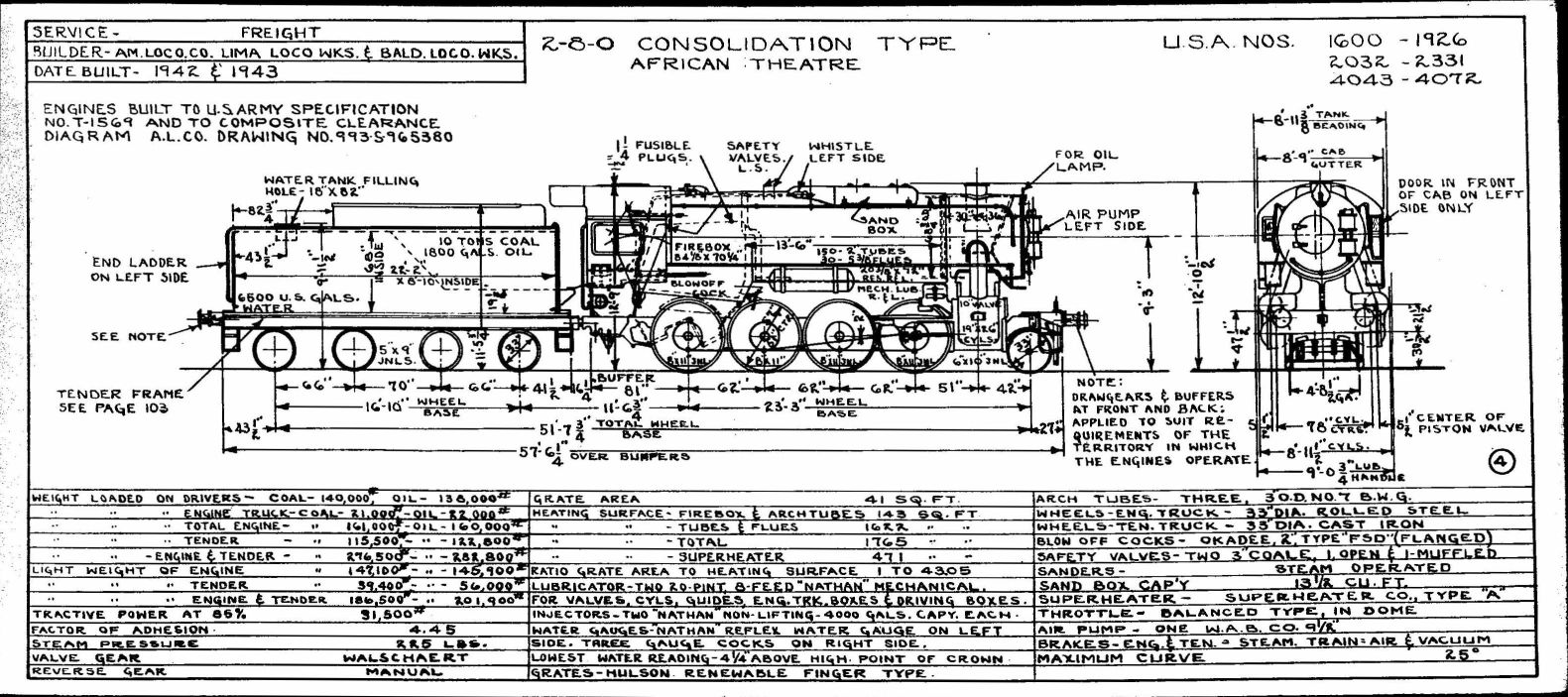

Here is shot of the S-160 spec sheet from the MRS folio as well.

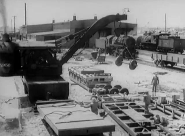

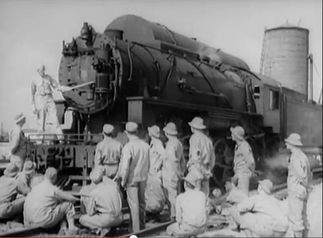

Here are the last images that I have of the 1600 at Camp Claiborne
