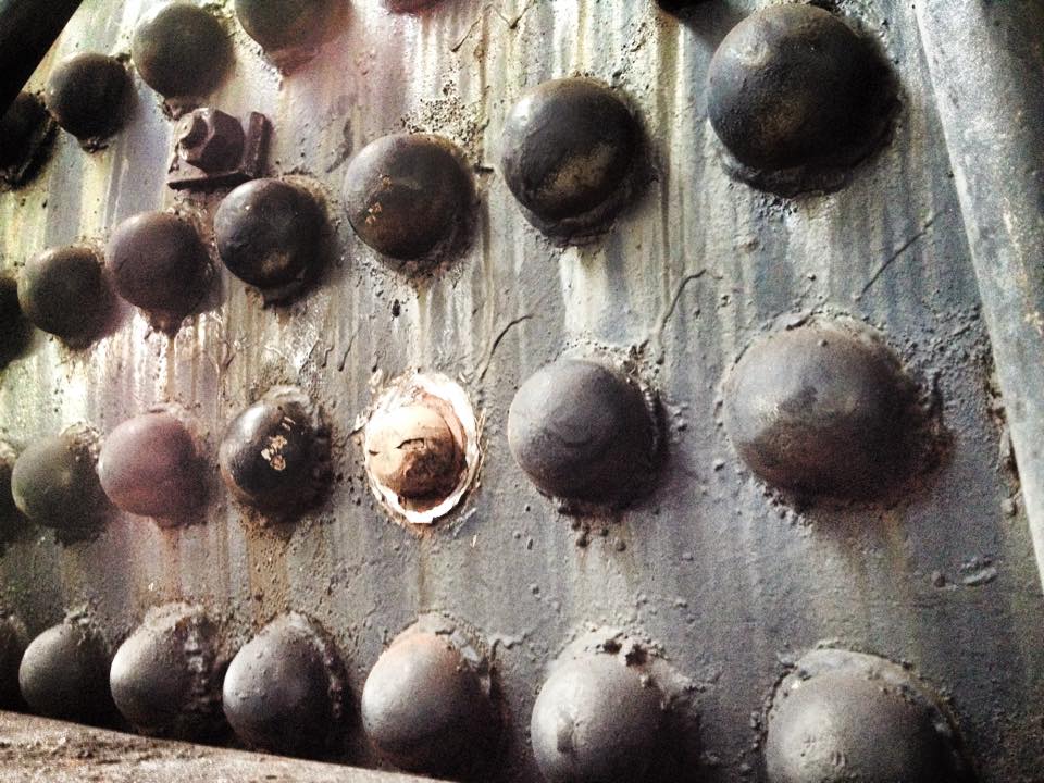

PostPosted: Mon May 25, 2015 3:41 pm
Posts: 540
Location: Minneapolis, MN
I saw this photo in a Facebook post. The poster, someone called "3985/844 Info" said that these are flexible stay bolt caps and were standard practice on the UP. I have seen photos of 844's firebox and have seen the more usual Flexi caps with the threaded plug. But since these look for all intents and purposes like rivet heads, they are new to me. Apparently the UP steam shop has fabricated a special tool for cutting these off.
Here's the link to the Facebook post.
https://www.facebook.com/10112103662175 ... =1&theater
Can anyone comment on these?
 Post subject: Re: Flexible Staybolt Caps
PostPosted: Mon May 25, 2015 4:53 pm
Posts: 618
Greetings:
Those are Flannery style "MK" flexible staybolt caps.
Not rivets, see the fillet weld around each one.
The "MK" assemblage used a hollow, "K" head flexi bolt seated on the wrapper sheet itself (no sleeve) and then the "MK" cap was welded over it.
Flannery made special tools to make the seat in the wrapper and remove the cap as well as the electric testing device to test the hollow bolts without removing the "MK" cap.
A lot of large, modern locomotives had these, but I have seen them on 0-6-0 tank engines as well.
These days, folks use a standard weld on pipe cap similar in size to the "MK".
Be well,
J.David

The MK caps do not have to be removed for flexible staybolt tests; that is what the electric test device is for.
I seem to recall seeing these caps on NKP 759. Other AMC power may have them as well.

The reason I am asking about these stays is that CFR49 Part 230.41 requires that "flexible stay bolts with caps shall have their caps removed for inspection..." Do these Flannery caps qualify as "caps"?
Even if there is an electrical device for inspecting these stays, Part 230.41 does not appear to allow any exceptions. Sounds like anyone with a locomotive sporting this style stay has a somewhat larger job ahead of them than otherwise.

One of the most prized and useful items in my library is my 1936 Flannery catalog.
Anyone out there who works on steam locomotives (or dreams of) should obtain a copy (available above) and study it. Most anything you'll ever need to know about staybolts is in there, including the tools needed to repair them.
In so far as inspection is concerned, it is true that they must be inspected every 5 years, but note that 49CFR Part 230.41(b) says that the cap need not be removed if it can be established that the bolt isn't broken. Hollow bolts are always used with MK caps.
Please note that not all hollow flexible bolts use MK caps. Our primary locomotive when I was with Steamtown in Vermont was No.1246 (now at Railroad Museum of New England), which had hollow bolts and a conventional sleeve and cap.
J.David
