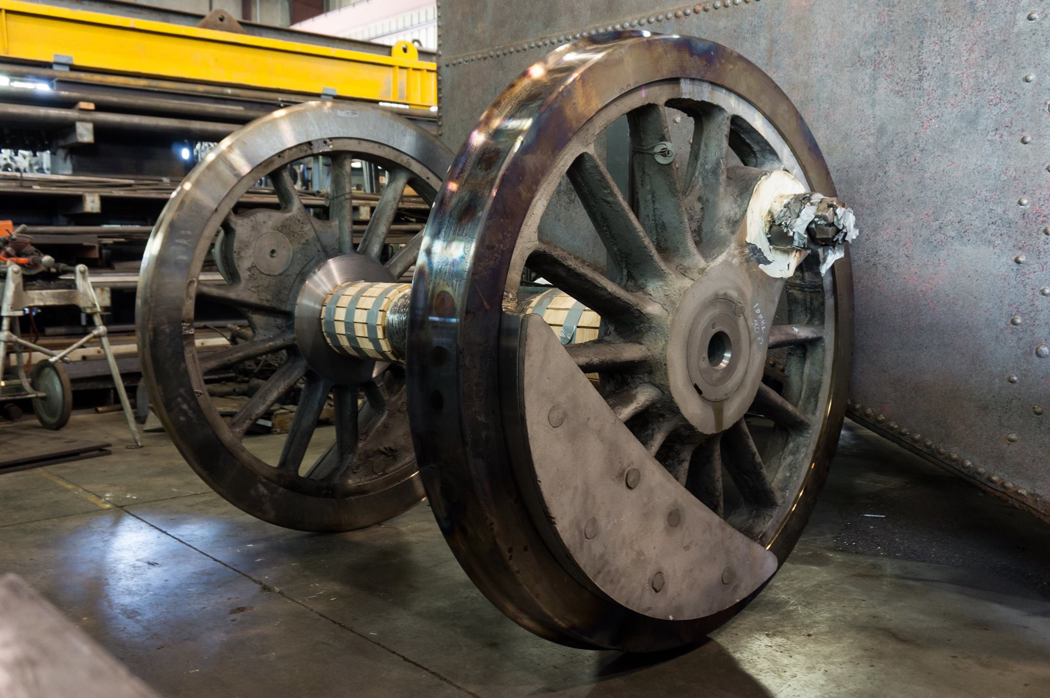

Recently the HVRR (Heber Valley Railraod) had the drivers for 618 turned. With this as you might guess they added tires on the locomotive with a "Ring Of Fire". Recently I have noticed when drivers are not under engines that they have this wood paneling wrapped around them about where the bearings would sit. Could anyone answer why this practice is done and what it helps/does? (Here is a picture of said drivers with new tires)-Photographer: Parker Wilson.

The wood strips are secured around the axles to protect the precision machined bearing surfaces from being marred during other shop processes. Smooth axles and well fitted crown brasses (with or without babbitt) are key to avoid hot journals during operation.
Other means can be used, but this method tends to be the most durable, especially if the bearing surfaces are covered with a waterproof coating to protect against rust during storage.

Very Interesting, thanks for the answer would you mind telling me some of the other ways to protect the machining?

some kind of plastic material strapped around similar. If something falls on on it like a dropped tool you won't ding the surface, the wood will crunch, not the metal.

Some kinds of wood, such as oak, are less suitable because they promote corrosion.
