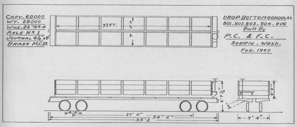

I dug out a copy of WP&YR equipment diagrams that I have.
Photos 8, 9, 10, 11 appear to match drop-bottom gondolas 801-805. These were 7-bay cars that were built by PC&F, Seattle, Wash. The diagram sheet carries the date of "Feb. 1940" this could be either a built date or a purchase date.
