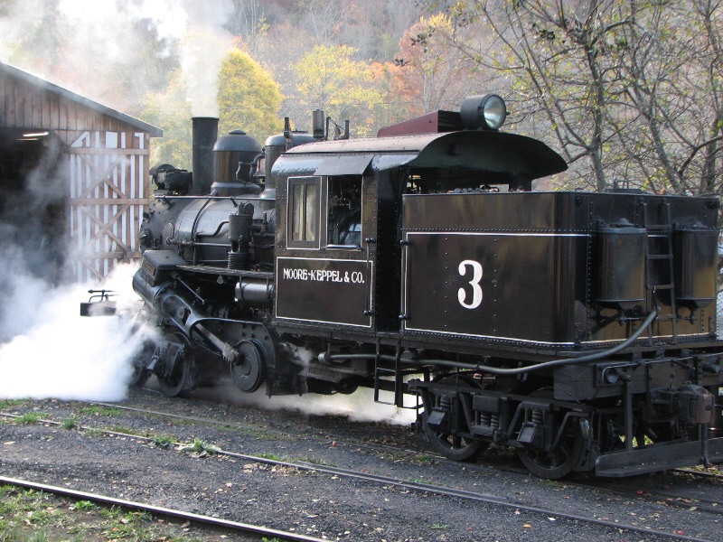

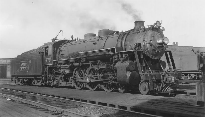

Pictures of 470, like the one below, show it with the same 3 note that Maine Central used on many engines. They had tops that look like short bell Hancock flat tops, with bowls that look exactly like Boston & Maine's (homeade) bowls.
I've heard of a few of these in private collections, and I know there is one on the Moore-Keppel Climax at Durbin, WV. I think it had the whistle when it went back to WV from the Connecticut Trolley Museum. Picture attached; you can see the whistle in front of the cab if you zoom in.
Agreed--it would likely be cheaper to buy an original 8" Crosby than to cast and machine a replica.

Gentlepersons, there are good reasons why I requested drawings. I agree, buying one from an antique dealer or collector would make good sense, and probably be less expensive, but at the present, I can assure you, in lieu of an individual handing one to us, perhaps the individual who took the original from the locomotive back in the 1960's, this is a course we wish to explore.
The Climax in the photo has, I believe, a genuine MEC passenger whistle. We're fairly certain of the size of the original whistle as well. It stuck way up above the boiler, like a thumb.
I think you're right--it's a real Maine Central whistle; but it's a 6", not an 8" whistle. An 8" Crosby would be WAY deeper pitched, sounding nothing like the original. A 6" Crosby would be way closer.

I wondered where #3's whistle came from. Now I know.
It has a nice pretty, mellow tone. But we only put 125 lbs through it.

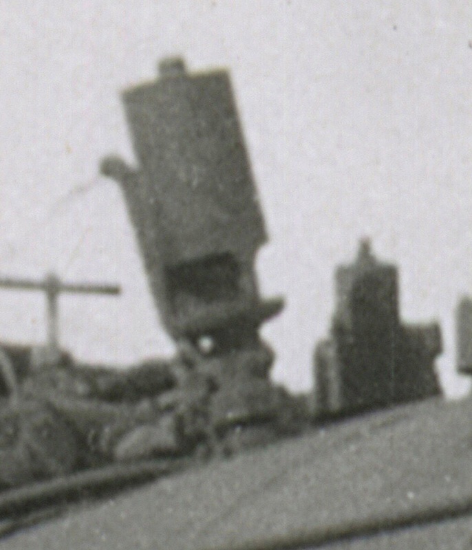

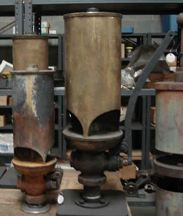

I'm taking the blame for determining it was an 8". The diameter of the safeties were about 7" and the whistle did not look to be smaller than the safeties. I assumed 6" meant the diameter of the top of the bell was 6" and it didn't make sense for it to be smaller.
Notice how the ports (lack of better term) on each chime on 470's are "squared off". Every crosby I've seen has rounded ports except for some 8". 470's could be modified as I have yet to find a whistle where they are as squared as hers. See photos
8"
6"
Peter Violette
