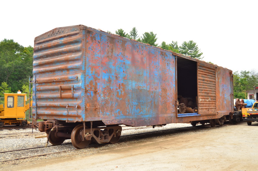

A leaky roof was the impetus for the car coming into the shop in July 2014, for roof repairs and an "dip job", with a minimal budget. Some obvious "project creep" occurred, and a much nicer restoration resulted. The budget was still reasonable, although the shop time was longer than originally planned.

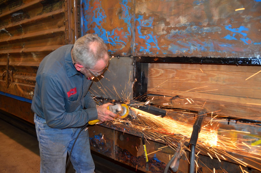

Work done included: patching roof corners and edges with new steel patches welded in, patching the 1975 B&M side patches, repairing rock salt damage to the steel floor, straightening the side doors (mangled and tough to close, they now take just two people and NO come-along to operate), new wood tackboards and steel brackets, roof, sides, ends and truck frames were scraped/sanded/prepped for paint, lettering was carefully measured and photographed for reproduction.

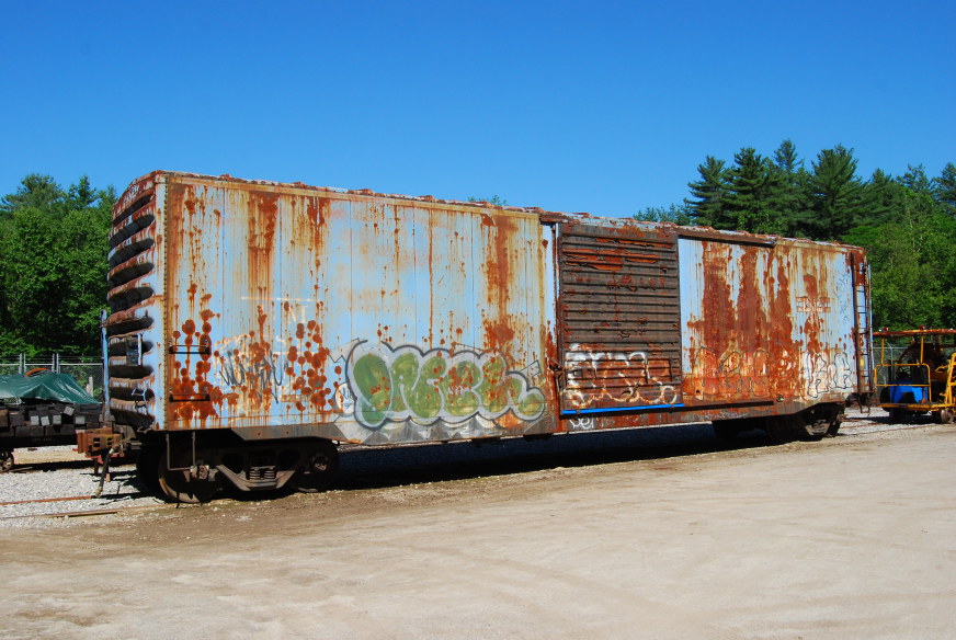

B&M 77843 at start of work, July 2014:

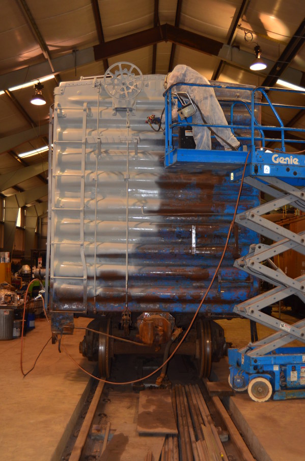

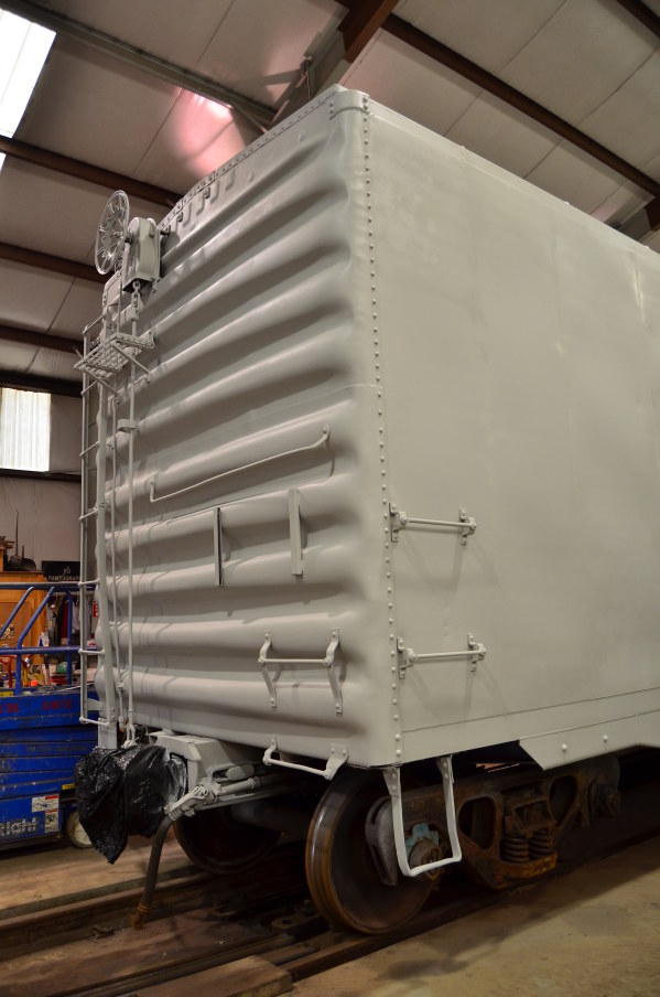

B&M 77843 ready for primer, Sept. 2014:

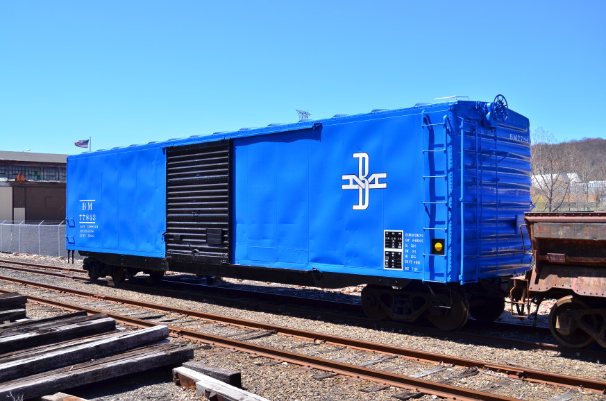

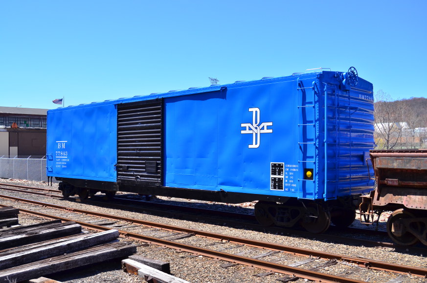

B&M 77843 ready for placement on Thomaston Station display track, April 25, 2015:
Final result was a nice freight car restoration and a nice display car at our station. The RMNE shop crew did a great job with this project, and some new people picked up some useful skills for future restorations.

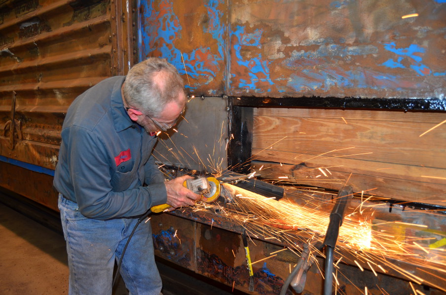

Replacing the rusted-out 1975 B&M side patch:
Priming the "B" end of the car. Ya gotta love those manlifts!!!

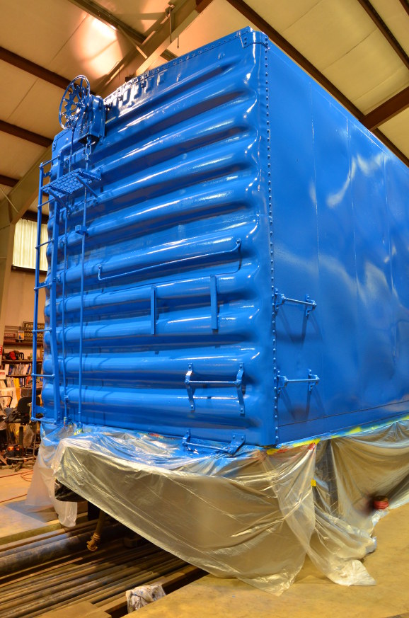

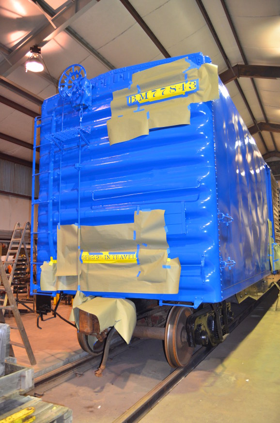

After painting the black side sills, trucks, and doors, those areas were masked and then the blue was sprayed.

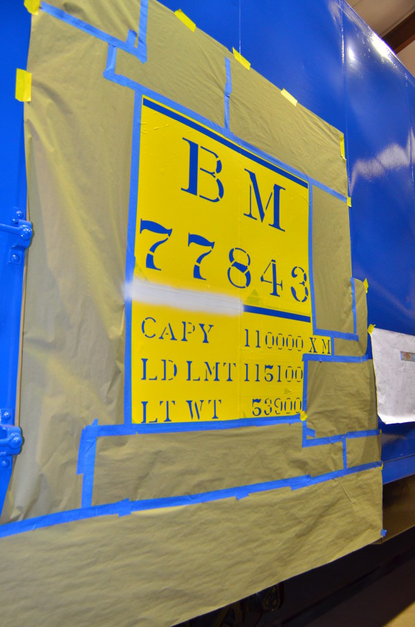

Stencil masks now applied, for painting the lettering:
Lettering being sprayed:
The lettering was done by working from Dale Nickel's careful photos of the original lettering, cleaning up and converting to a CAD file by Allen Pomeroy and Tony Pratt, and was then cut from low-tack vinyl stencil material by our local sign shop. Tony lead the stencil application crew.
The sign shop also produced the B&M herald vinyl decals, and the consolidated stencils.
Paint application was done with an inexpensive spray gun and a pressure feed pot; the stencil painting used a small Harbor Freight gravity cup gun ($16.00 !!), which worked very nicely with no overspray.
Steel roof repairs and side repairs done by Sam Walker, wood work by Stan Bogatz and his woodshop crew (Win Bissell and Kurt Viener), door straightening using a shop-built clamp rig was done by Rich Bingham and Jay Hartmann. Many others worked on this car and helped make it look so good.
