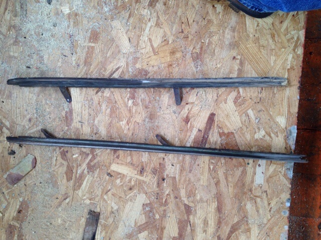

Steel makes more sense than aluminum since the screens are steel, frame and all. I wonder how we ended up with wood since there is no evidence of the windows being disassembled and the glides look like something like mahogany. I think they are called glides. :)

Could it possibly be wood due to the metal shortage during war time? Have you checked any other cars, they're getting harder to find but there are still some around.
Due the quantity of these they made, I'm guessing variations could be possible, especially under wartime conditions.

That could fit too. I have been chatting with member of a group that has a couple of the cars and I believe he said their cars had wood sashes too. Maybe they were supposed to be steel and were made wood due to metal shortage as you suggest.

I am just trying to determine how to seal the glass in a wood sash if that is what was used on this one. I don't think standard glazing putty or something like that would have been used or held up to the punishment. How did Pullman seal their wood sashes?

I worked on the heavyweight Pullman INGLEHOME, a number of years ago, and that car has wood sash. IIRC, the glass was held in with mahogany "glass bead" molding, which looked like 1/4" quarter round, but had a slight rounded edge on the side that met the wood sash. Both glass and molding were bedded in caulk.

The WW2 troop sleepers did not have wood sash as originally built; they used a metal sash, Adlake if I recall. This applied to both the original cars with center step wells and the 1945 cars , with strap steel center steps. Any wood sash found in a troop sleeper is a post-war (and post-troop sleeper use) alteration, most likely done by the railroad buying the surplus car(s) for other uses (work train bunk car, caboose, express/baggage, etc).
