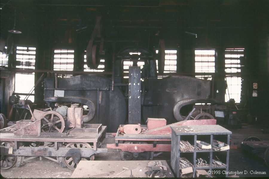

I would venture to say that the gas car on the left in this photo is a potential contender. Other than being captive in the EBT shops, I know nothing about it.
http://www.spikesys.com/EBT/roster.html
 Post subject: Re: The oldest internal combustion rail car around?
PostPosted: Mon Mar 16, 2015 11:10 pm
Posts: 550
I was also thinking of the EBT speeders, but I don't know when they were built. I can't imagine any of them are earlier than 1920 though, so they're probably not in the running.

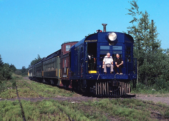

PostPosted: Tue Mar 17, 2015 12:27 pm
Posts: 548
Minneapolis, Saint Paul, Rochester & Dubuque Electric Traction Company #100
(Whew! what a mouth full).
General Electric 1913.
Think of it as two GE Gas Electric Car cabs back to back.
Dan Patch Lines.
PostPosted: Tue Mar 17, 2015 2:09 pm
Before anyone becomes overwhelmed by the antiquity of Dan Patch Lines 100, keep in mind it too has been re-powered, just not as recently as the gas car at Strasburg and the McKeen car in Carson City. Here's a link to some history:
http://www.mtmuseum.org/roster.php?page=dpl100

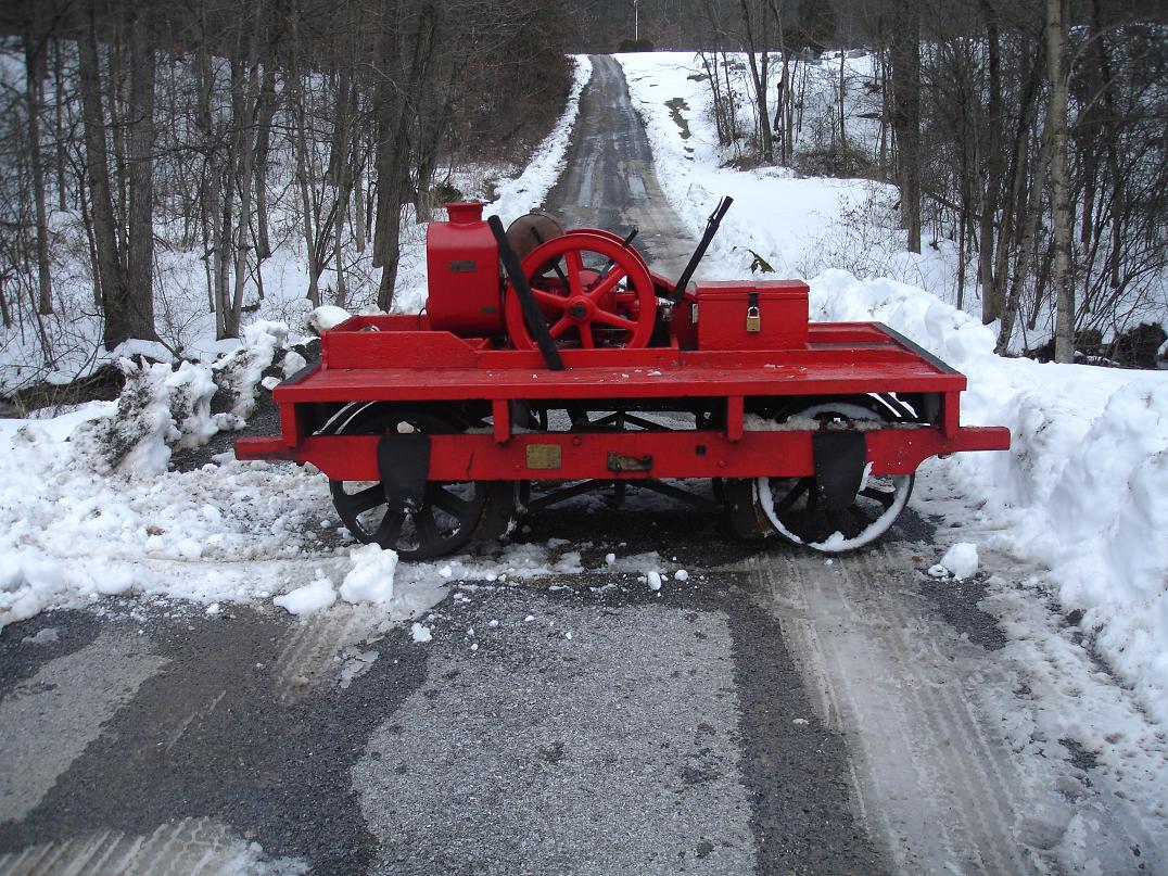

This Mudge equipped velocipede is about the oldest piece of motorized MOW equipment I know of;
http://www.sbdepotmuseum.com/home/mudge-motor-car.html
cv the civil E in NJ

Mr. Anderson, I don't know how long it been since you have been to the EBT but that speeder car has not been captive in the shop since 2007. It is one of the few pieces of EBT equipment that is currently operational. None of the speeders on the property are older than 1920.
