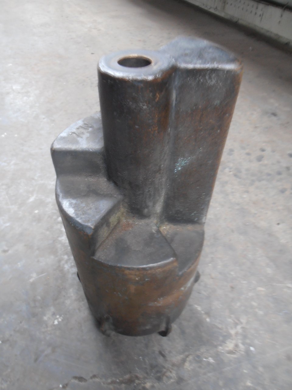

The owner of the Beyer-Garratt we are working on here in New Zealand today, provided a Nathan six chime whistle to fit on it.
What would have been a typical application for such a whistle back in the day?
Thank you,
TH

 Post subject: Re: Nathan six chime whistles
PostPosted: Mon Mar 16, 2015 8:29 am
So that the train can make a really loud "whoo, Whooo-oohh".
PostPosted: Mon Mar 16, 2015 9:24 am
Posts: 12179
That's what's called the "bell" of the whistle--what the steam blows across to make noise, much like the bottle a kid blows across. You still need the rest of it--the bowl, languid plate, and shaft holding it all together. Oh, and either an integral valve or an external whistle valve.
PostPosted: Mon Mar 16, 2015 9:43 am
Posts: 366
Location: Skagway, Alaska
Those are fairly common whistles, but they seem to have a prize factor among collectors and usually fetch over $3,000 on eBay. A lot of railroads used them, and there are still a number of engines that use that same whistle regularly on tourist railroads. The White Pass & Yukon 73 and I believe 765 and 1225 have used them quite a bit in the past, among others.
PostPosted: Mon Mar 16, 2015 10:48 am
Posts: 1119
Location: Warszawa, Polska
Typical Application or Typical Installation?
PostPosted: Mon Mar 16, 2015 10:49 am
They were widely used so there's no typical....other than something larger than industrial goat size, and not from a railway that produced its own distinctive whistles.
PostPosted: Mon Mar 16, 2015 2:18 pm
Posts: 347
Thanks for the replies.....yes we have all the parts.
No idea yet where it will be fitted, cannot go up on top vertically though as it would exceed the railroad loading gauge.
TH
PostPosted: Mon Mar 16, 2015 4:02 pm
Posts: 1119
Some locomotives had their whistles installed horizontally for that reason. The Big Boy's are one example.
PostPosted: Mon Mar 16, 2015 5:12 pm
Horizontal or diagonal will be fine. My preference is for diagonal. I saw (and heard) one of these on a tiny 2 footer on the Ffestiniog several years ago, so I am sure it will work for you.

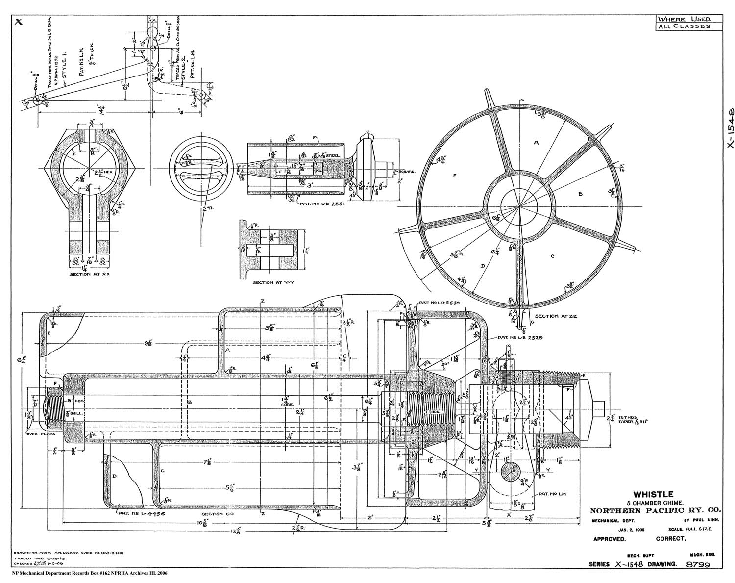

 Post subject: NP 5 chime drawing
PostPosted: Fri Mar 20, 2015 6:45 pm
Posts: 548
A Northern Pacific Drawing of a Five Chime Whistle
PostPosted: Fri Mar 20, 2015 8:13 pm
Posts: 554
Location: Dallas ,Texas. USA
Thanks you HusdonL!
