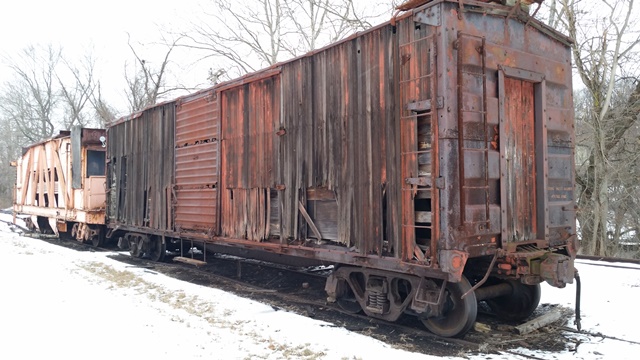

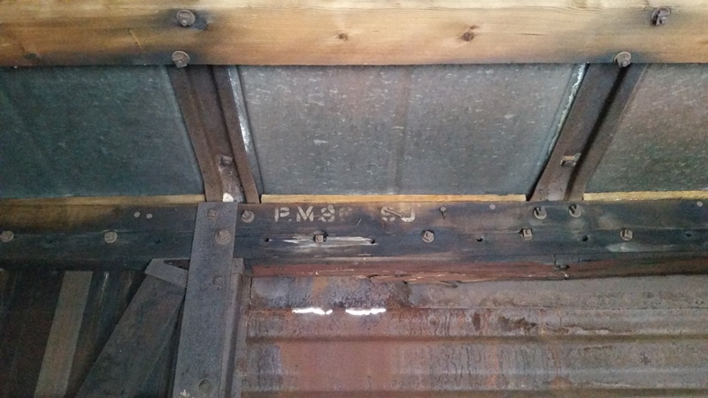

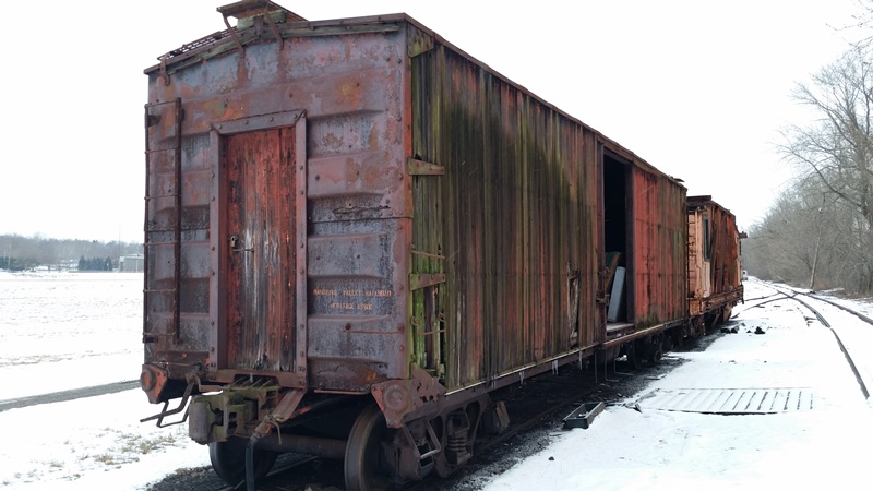

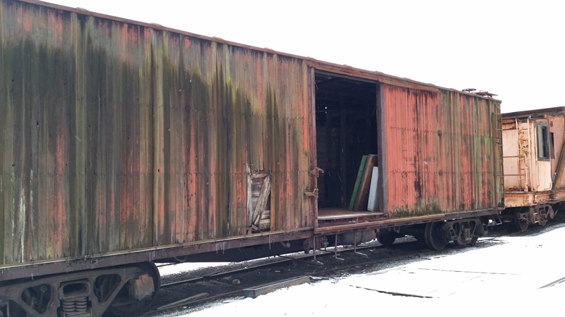

The Mahoning Valley Railroad Heritage Association in Youngstown, OH is planning to scrap a former Pere Marquette wooden boxcar, number 86690 (I think) if a savior is not found. I think they would give it away, or at the very least could save parts off of it if anyone is interested in anything from the car. I don't know much of the history on the car other than it was last used as a tool car on the Youngstown & Southern Railroad.
If interested just send me a PM.

86690 would be a valid number for a car that matches the appearance of the one in the photo. According to Pere Marquette Revenue Freight Cars by Million and Paton, this is one of a group of 1500 automobile cars built by the Pressed Steel Car Co. in 1923. The original door opening was ten feet, covered by a six foot main and four foot auxiliary doors. The cars were converted to standard box cars with six foot door openings during 1937 - 1943. The car in the photo appears to have its original Hutchins roof and ends from the same vendor, and one original steel door. The end door is obviously a modification for work service.
These cars were originally equipped with Klasing lever hand brakes... I wonder if it is still on the other end?
This car would make a nice addition to someone's period photo freight... a very typical car from a rather unusual road.

Tom -
If you were going to restore this car, you would need to probably reside most, or all, of the whole car (I'm assuming that the other side is just as bad as this side) but that can be done. Is the missing side door laying around somewhere, otherwise new door needed. The Hutchins ends are probably rare; do any other examples of those ends exist? The parts cut out could probably be replicated with new steel. Again, can be done. Does the other end also have a company service door cut into it? We have a NKP camp car at HVRM where the Nickel Plate only cut a door in one end. Fishbelly frame is neat. Hope someone takes the car. I agree that a Pere Marquette box car would look good in a photo freight.

It looks to me that the "missing" side door, which Rick informed me via PM is with the car, is laying on the ground next to the door under a layer of snow.

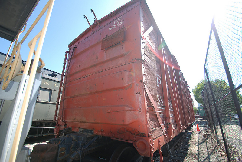

I am fairly positive that the B&O museum's Pere Marquette box car is also from this same class. It features these Hutchins ends and is also of wood construction, but does not have a door in the end of the car body. It also is not in the greatest condition at the time being.... I would love to get dimension of the Hutchins end panels some day!

On my visit to the B&O Museum a few years ago, I recall seeing a PM single sheathed (outside braced) boxcar, but don't recall seeing a double sheathed boxcar like this one. Perhaps I missed it. Also don't recall what type ends that car had.

Here is a picture of Pere Marquette #88958 in Baltimore. It looks like the two cars, do have matching ends.
Hope this helps,
-Andrew

The other side is in far worse shape, but so far the interior of the car appears in fairly good shape as is the floor. The roof does not leak. The far end does not have a man door cut into it.
The MVRHA has been storing railcars in an industrial park since 1988. They now own their own property and would like to get the cars moved onto their property while they still can. They don't have much space, and over the years the collection has deteriorated due to a lack of volunteer participation. Getting rid of the boxcar is the first step in paring down the collection to a size that can be sustained.

Interestingly, from the right side photo, it appears this is a wood framed car, as one of the side posts is visible through the hole in the sheathing. The equipment diagram reproduced in Art Million's book seems to confirm this, as it states "SUPERSTRUCTURE - WOOD."
1923 is very late for a wood framed house car, and this order must be some of the last cars built this way. While the ARA had a double sheathed boxcar as one of their recommended "standard" cars after WWI, that car had steel framing behind the outer sheathing.
So, the repair is likely to be much more involved than just replacing "slats." On the other hand, the car appears complete, even down to the long obsolete Carmer cut levers, and being wood framed, the repair could be a lot easier to do for a group that lacks heavy steel fabrication capabilities.
