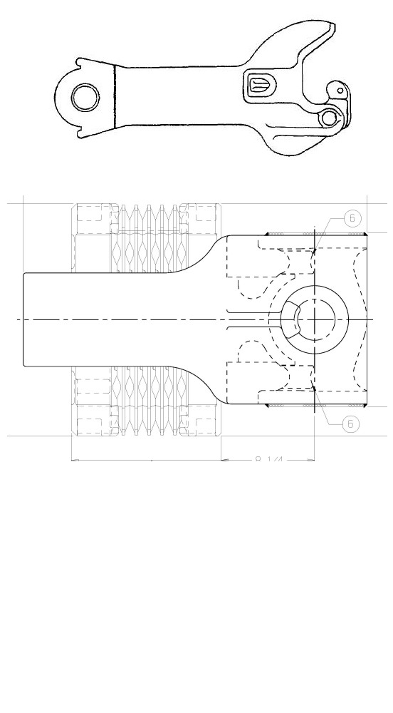

From the EMD catalog, an alignment control coupler has the ears on the left side of this drawing.
[attachment=0]alignment control coupler & draft gear.JPG[/attachment]
Now from a manufacturer’s drawing of alignment control draft gear above; Item # 6 is listed as an “aligning plunger”. This feature is not in their non-alignment control draft gear drawing. How do the ears of the coupler interact with the “aligning plunger”? Can anyone describe how this actually works? I would have thought the coupler ears would bear against the right side of this piece. Does anyone have a drawing or pictures of the whole works. Does anyone have one apart on the ground that I may look at?

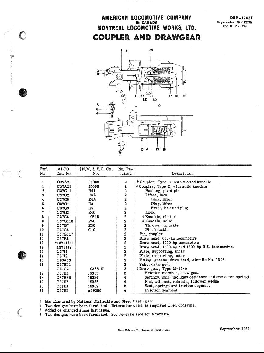

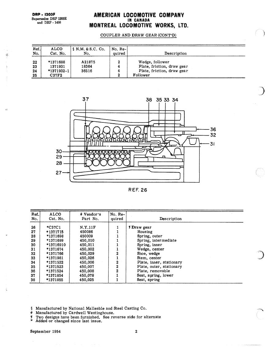

Here are the ALCO coupler and draft gear parts pages.
[attachment=2]Pages from ALCO DRP-219 Mopac S-2 parts list_Page_1.jpg[/attachment]
[attachment=1]Pages from ALCO DRP-219 Mopac S-2 parts list_Page_2.jpg[/attachment]
I am thinking that on the round end of the coupler a couple of seats could be milled out and a square/rectangular bar welded in. I would then think annealing would be in order to insure that the welds did not crack. Engineering the proper dimensions would then allow the coupler to swing to a point and then contact # 25, the follower. I would think this would be much less costly than replacing the entire box. Why wouldn’t it work? Ready for the barrage.
