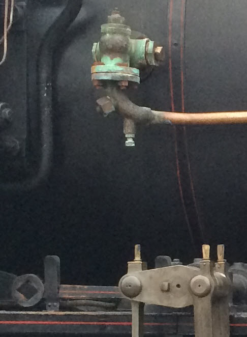

Found this photo, and clipped a closeup of the valve. You can see the wrench in its running board storage mount. The plug valve is behind the check valve.
Oh by the way, see those oiling points on the valve gear hanger? Those are wooden plugs sealing the holes. The holes are threaded, and maybe a long time ago there were metal plugs, but they are all wood now. And, we carry a supply of replacements for when they fall out on the road.
Did I mention this engine runs in traffic at 60 mph?

The method of hammering has definitely proven to be practiced! One look at both valve bodies, and all of our spares, show signs of being beat on many times throughout their lives. The practice with the valves is to always turn the valve clockwise to help prevent the yarn from being torn by reversing the rotation. When banking the locomotive, the wrench is put on so it is in the 9 o'clock position and rotated till it is vertical in the 12 o'clock position. The wrenches are left on overnight so it can be clear and obvious to crew members that the valves have been shut off. It also helped explain to this newcomer on his first run day why the overflow pipe was a constant stream of water at 5 am when he tried to fill the boiler (an embarrassing and funny memory!). When opening the valves in the morning or after servicing, the wrench is put on the valve in the 6 o'clock position, hanging down, and rotated to the 9 o'clock position where it is horizontal.
I would definitely agree that the valves need a serious re-think for their future operational life!
