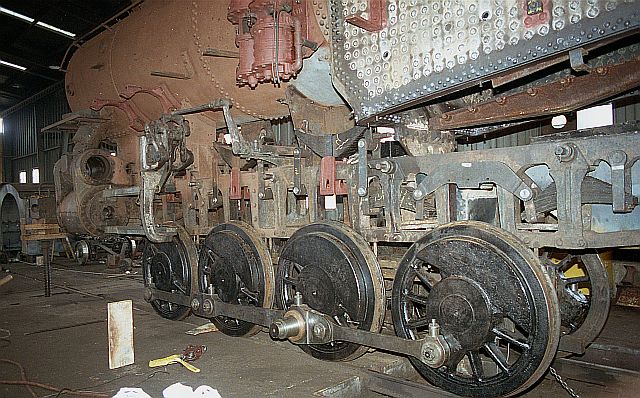

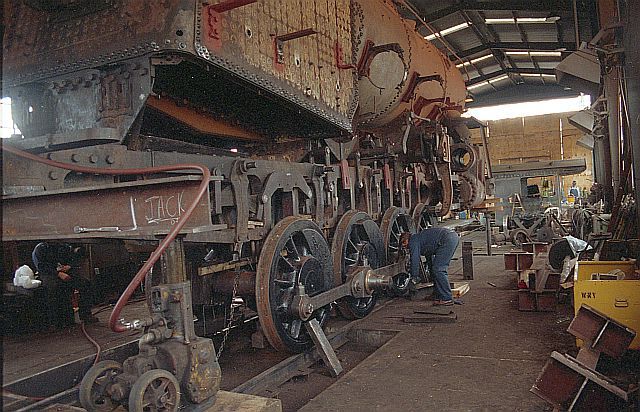

Western Maryland Scenic RR uses a system of jacks. The former WM Carshop had a pair of Jacks in the floor that were refurbished and those along with portable air jacks have done the heavy lifting when #734 has needed wheel work. The attached photos are from the early 1990's during #734 first rebuild in Ridgeley.
