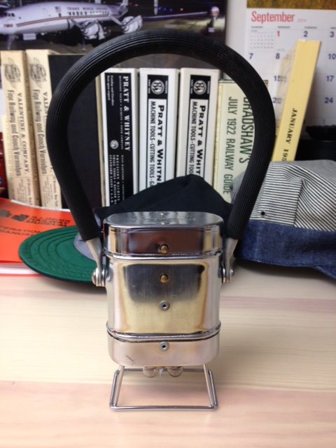

Here's the passenger train-sized battery lantern Howard mentioned. It uses 2 D cells. I bought this new from the Rolling Stock Company, a mail-order railroad clothing supplier back in my teenage years of the mid to late 1990s. Howard is right, it fits nicely in my conductor coat pocket, as well as the pocket on my denim chore coat. I've seen originals where the "signal" bulb is painted red, so the engineer can distinguish from light used to see, versus giving an actual signal.
Lantern has an inscription on it, saying it is made by "Streamline Products, Lebanon, Missouri." I could never find them when I lived in St. Louis.
