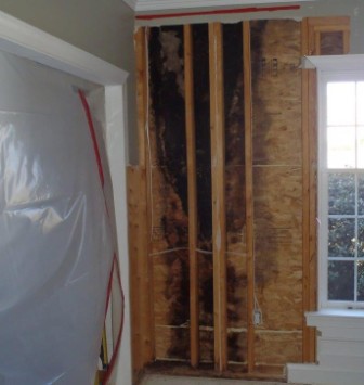

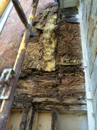

I can't comment on its installation over a metal substructure but brick and stone veneer over sheathing has been a boon for the mold remediation industry. Takes about four to seven years to fully incubate.
"Honey, why are there mushrooms growing behind the television in the family room?"

I submit these images in support of my earlier post....
