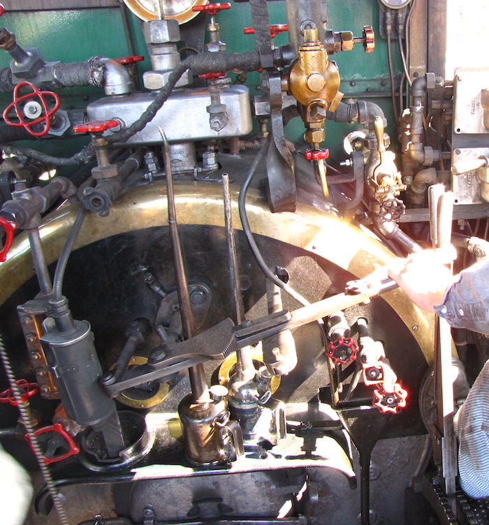

I'm looking for an appropriate and useable oil can for a 1904 Porter locomotive.
I suspect the bronze ring, which measures 4-1/4 inches inside diameter and 1 inch deep, is for an oil can. The oil can in the photo doesn't fit properly because the handle is too low and the body interferes with the throttle.

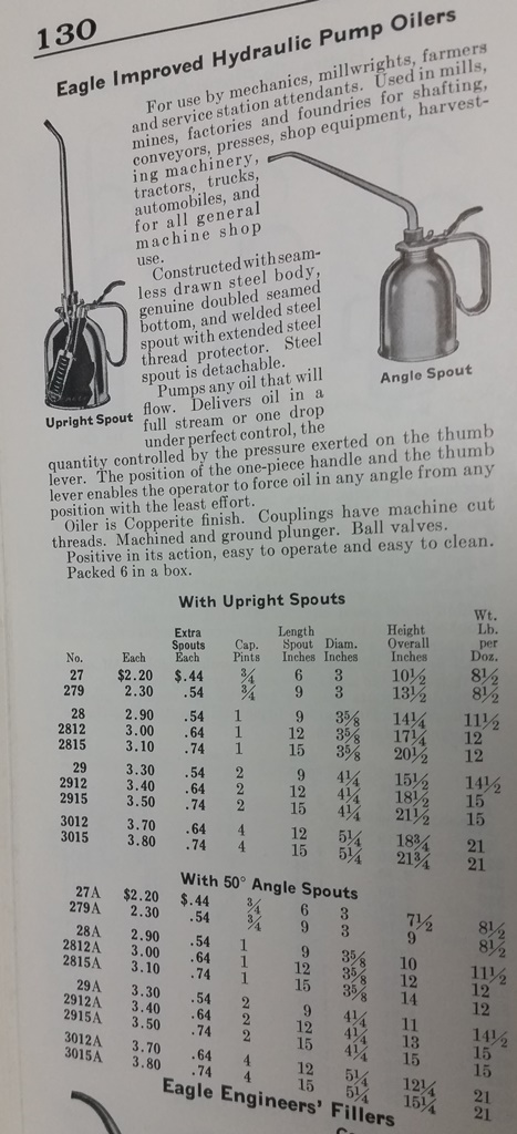

For some reason I've become acutely interested in Porter locomotives as of late, and would like to know a bit more about this locomotive. What is it? Where is it? Operable or static?
Here is a photo of the Eagle oilers that an industrial supply house listed including dimensions. You need something that is 4" dia. or less and with a handle that begins at least an inch up from the bottom of the can. I have a few Eagle railroad oilers at the museum and I'll measure them when I get over there this afternoon.

I've never had any problem keeping light oil warm on the backhead. Maybe I did it wrong all those years...
