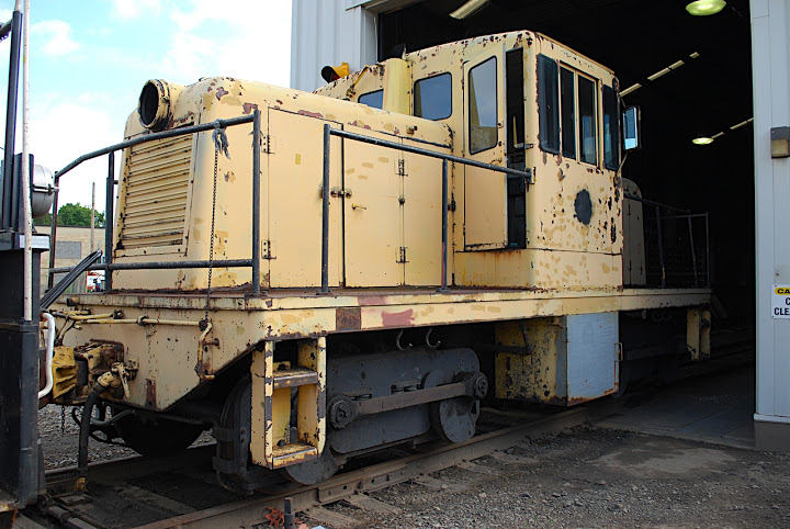

File comment: The code B-B 90/90-2GE733 looks like the class code of a 45 tonner. Am I correct? Being built in 1952, it should look similar to our 1950 built 45 tonner:
