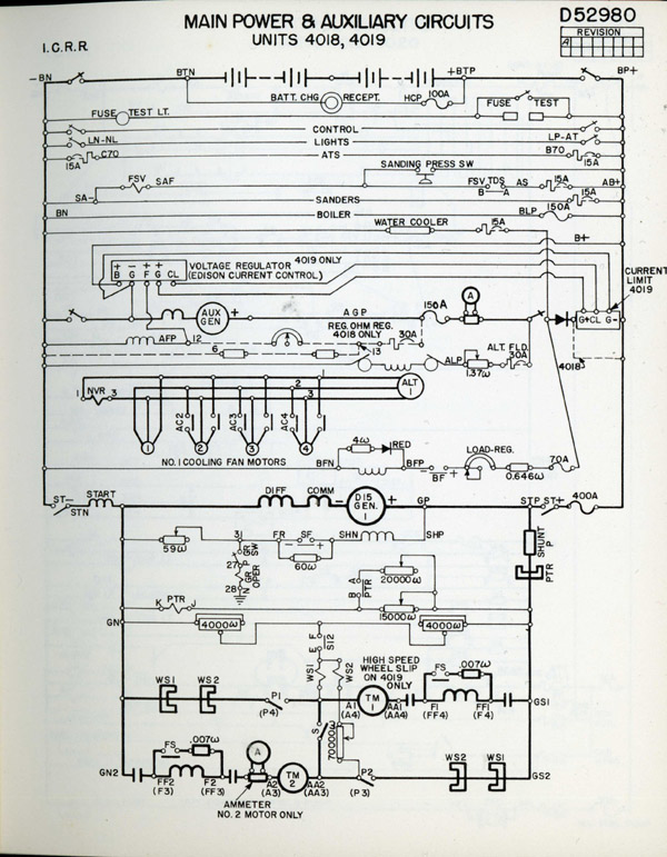

An IC booklet I picked up at a show a while back and a sample page. Note the applicability to just two units. Some pages just apply to a single unit and even here there are minor differences between the two units. (These were E8A's.)
Steve

That Illinois Central diagram is a really good example of what happens in the aftermarket, showing the differences in installed voltage regulators between unit 4018 and 4019. A salesman walks into the Mechanical Department office with a new electronic device, and the CMO says "Okay, we'll buy one and test it on a locomotive". So they get the equipment for one locomotive, install it, and forget about it. The locomotive is then different from everything else in the fleet. Maybe they don't follow up and install it on the other units, or the manufacturer changes the design and that particular device is dropped from production, or some other vendor comes in with a comparable device and the railroad likes that product better and buys it for the rest of the fleet. So you end up with these strange individual wiring differences as a result of partially implemented modification projects. Unless you update all the wiring diagrams like the Illinois Central has done, this is left to confuse everyone who subsequently encounters these modified locomotives.
Several members of this board have worked together on a number of troubleshooting exercises involving the former Bangor & Aroostook F3's, which have some features found on F9 locomotives as the result of application of an obscure series of EMD ModRec's, but those devices were not identified with the same component names used on the F9 wiring diagrams. This causes confusion many years later when you are trying to troubleshoot locomotive problems. The locomotive no longer matches the original diagram, what is installed looks like a later production locomotive's equipment, but the component names are different from what is shown on the later locomotive's wiring diagram. So if the schematic was never updated you end up needing the original documentation for the modification.
