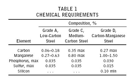

John E. Rimmasch wrote:
Suffice to say for this conversation, the acceptable ranges of copper and nickle have changed over the years (for SA 178A tubes) and as such, we are seeing a wide range of issues in the industry.
Nope. If the copper is more than a trace element, greater than 0.01%, it has to be greater than 0.20% and noted as "copper bearing" on the MTR. If the nickel component is greater than 0.01%, it is an alloy steel or scrap metal.

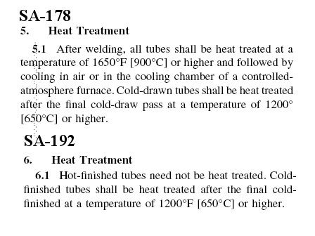

Tube ends not annealed prior to installation
Back in the 1950's, the SA-87 spec allowed for wrought iron or steel, welded or seamless, annealed or unannealed. That morphed into SA-178 ERW and SA-192 Seamless. Dixon Boiler Works in LA would send out 2 guys and a truck that could retube and 200 BHP Scotch boiler in one day. The boiler industry didn't have time to anneal every cut tube in every commercial boiler. Some time in the '60's the ASME changed the specs such that all carbon steel boiler tubes were required to be furnished annealed from the tubing mill.
The main reason ERW tubes are getting longitudinal cracks is the installation. People are rolling and welding tubes and crawling out of the firebox. The sharp insde edges of the tubes are exposed to furnace gasses and radiant heat. If you count every exhaust, it does not take long to roll up a million thermal fatigue cycles on the sharp edge that will find the ERW seam and start a thermal fatigue crack. The solution to the longitudinal cracking problem is to spend an extra day with an air hammer and a beading tool to knock over sharp edge of the tube.

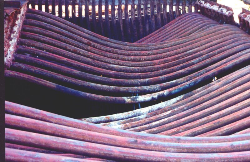

Just to show how sinewy ERW tubes can be, take this example.
The boiler ran for 20 minutes bagasse fired before it became obvious the feedwater valve had closed. I received a call one morning about 7 from the insurance inspector for the mill telling me it melted and expect a call. I was the AI for the repair firm. When the call came at 9 am asking how soon I could get to Maui, I told them I was booked on the 11am flight.
There actually was a bigger problem than just the melted boiler. That would be 2 miles of 18" diameter rock candy wrapped in steel pipe, if they had to wait for the proper boiler repairs to flush the sugar mill. Most of the leaks were tears where the tube sections were welded to boiler supports. There were no ERW seam leaks. The Insurance Inspector and I agreed to weld the tears, hydro to 450 psi(normal mawp) and let them run for a week at 150 psi and no more than 50% firing rate of 100,000# per hour. These were 2-1/2"OD ERW tubes about 30 years old.
