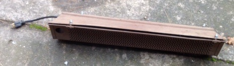

I was cleaning up the shop and decided the best way to get rid of some electric heaters was to reinstall them in the car. (Chicago South Shore car #1 with later walkover bench seats). Here is a picture of one of them, and a close-up of the builder's plate.
File comment: Railway Utility Co heater

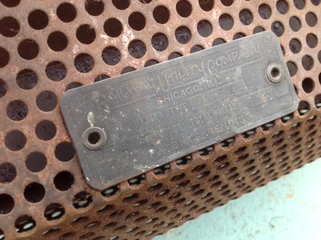

File comment: Railway Utility Co builder plate
Now, these are simple units. Railway Utility Co. only makes the enclosure. They contain two heater elements within. Here is one heater element and a close-up of the stamping.

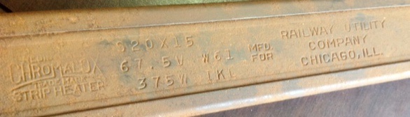

File comment: Chromalox heater element
File comment: Chromalox stamping

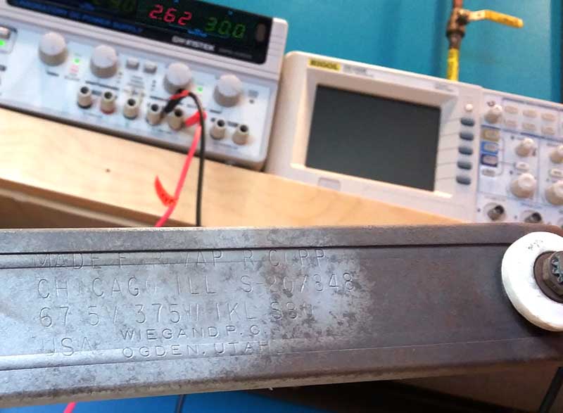

Found a different type of heater in South Shore #36. It's not labeled well and seems largely inferior to the Railway Utility Company. There's nothing on the chassis to say whose it is, but here's an interesting heater element.
It's not a Chromalox heating element, it's a Wiegand. It's a dead ringer for a Chromalox and intermixed with them. Here's the interesting thing. Wiegand is the founder of Chromalox.
The heaters have the exact same values as the ones I documented earlier.
This element is not made for RUCo, it's made for Vapor Corp. (who also made those caboose stoves). That tells us who makes the heater - they have no other distinguishing markings.
Just as the Wiegand elements are dead ringers for Chromalox, the Vapor Corp. heater assemblies are the same fit as the RUCo. heaters, but a different style.

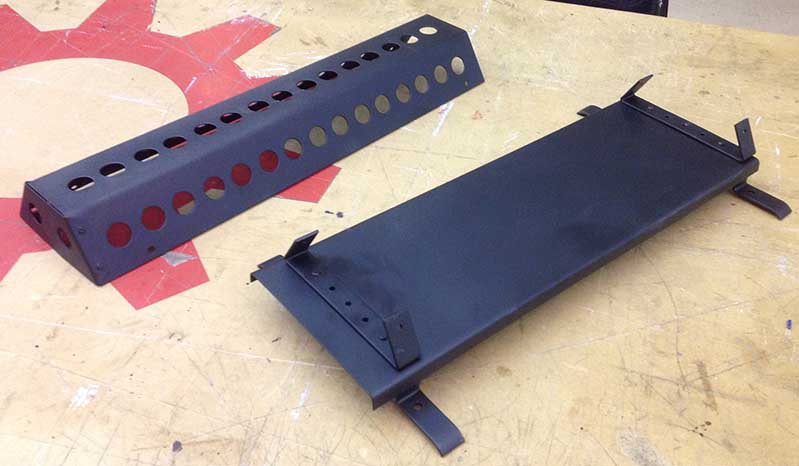

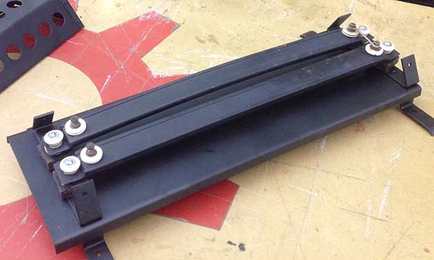

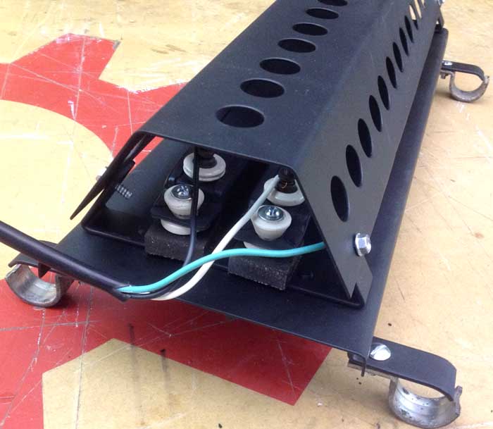

Here is a Vapor heater assembly freshly powdercoated.
The heating elements installed. The elements proper were not powdercoated but got high-temp BBQ paint. The insulators were masked and carefully cleaned up.
Fully assembled, ready for burn-in. Literally. It takes 20 minutes to burn off that "new heater" smell.
Those white insulators (with the bolts through them) are (still) supplied by Chromalox for applications 480V and up, or in series, or direct heating of air - all three apply here.
The bottom iron seems complicated enough that I wonder if Vapor and RUCo didn't work together or inherit patents and tooling. I went crazy trying to find the J-hooks which clamp to the seat frames. You are seeing an original, turns out they are precisely wall clamps for 1" EMT thinwall tubing, even with the little nub on the end which makes it grab the tubing. It's obvious that this product was engineered to use those.
