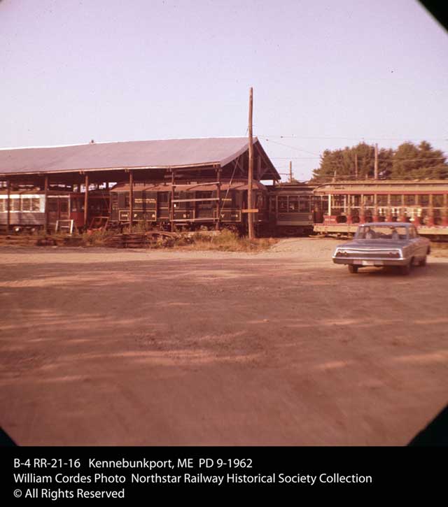

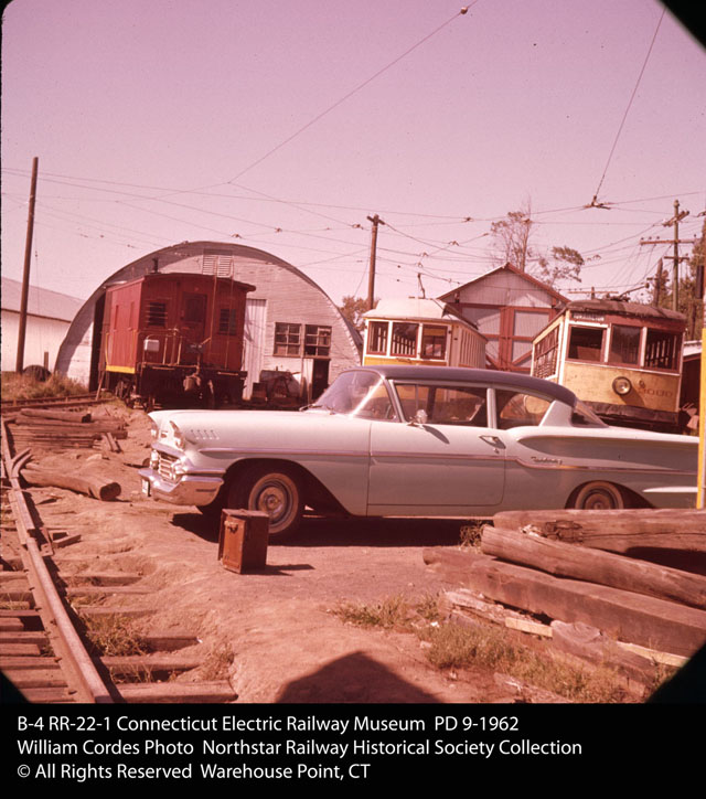

The good old days ;-)

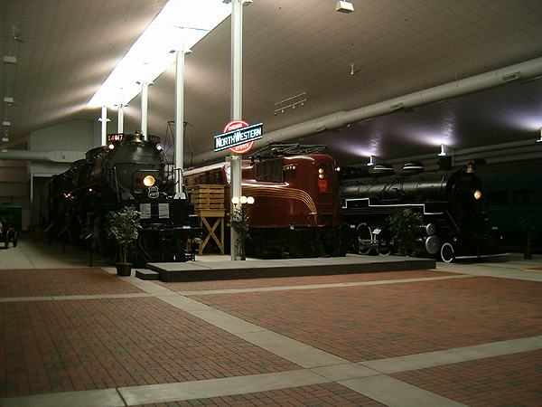

For obvious reasons, there is a tendency to cram as much equipment as possible under roof. However I would suggest leaving sufficient open floor space for complementary interpretive displays and to make an attractive facility for rentals. Receptions, parties, banquets, etc. can all be valuable income producers. I like the setup at the National Railroad Museum in Green Bay, Wisconsin, for this reason.
Alan Maples
