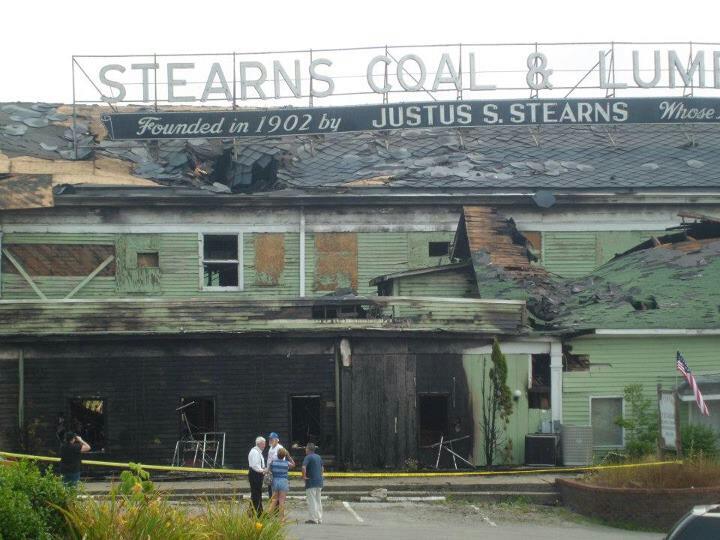

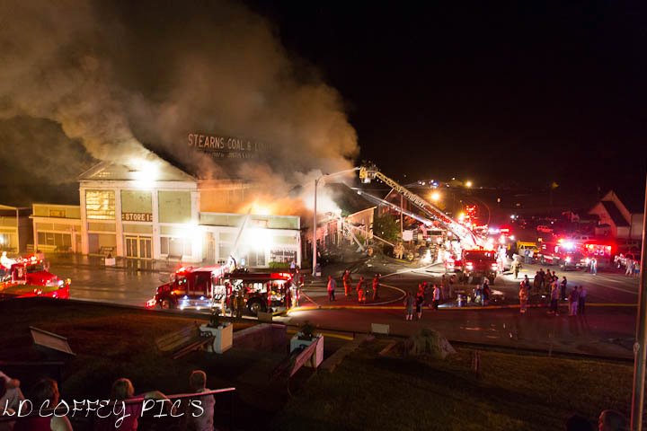

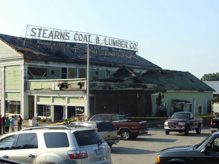

While not explicitly rail related, this is newsworthy. Many tourist railroads exist in conjunction with historic properties, and Stearns is one of them. The McCreary County Heritage Foundation operates the railroad and manages the National Historic District. This past Saturday is a date that will long be remembered. The Coffee Shop/Restaurant, Original movie Theater, and Company Store #1 were burned, with severe damage to Store #1 and the restaurant and theater a complete loss. Apparently the fire started from a cigarette or bottle rocket in a very dry mulch bed and shrubs adjacent to the restaurant. This is a severe setback for Stearns.
Take note and learn. Defend your properties.

Compound tragedy. I wonder if there's enough structure and interest to restore the classic building?
