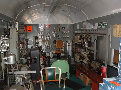

Reading Company T&HS has the LEMTU (Locomotive Engineer Mobile Training Unit) and it was operable, I believe it was last used by Amtrak in the 1970s. On the near left is an AB freight car setup, just pass that is a 26L with second generation control stand, middle back is a complete 24RL locomotive setup with a drum style controller, and on the far right side are the typical relays one would find in a first generation unit, these all operate in conjunction with the drum style controller and related switches. The row of lights above the relays indicate by name which relays are energized. It was a great educational tool, nothing like hands on learning.
Mike Tillger
