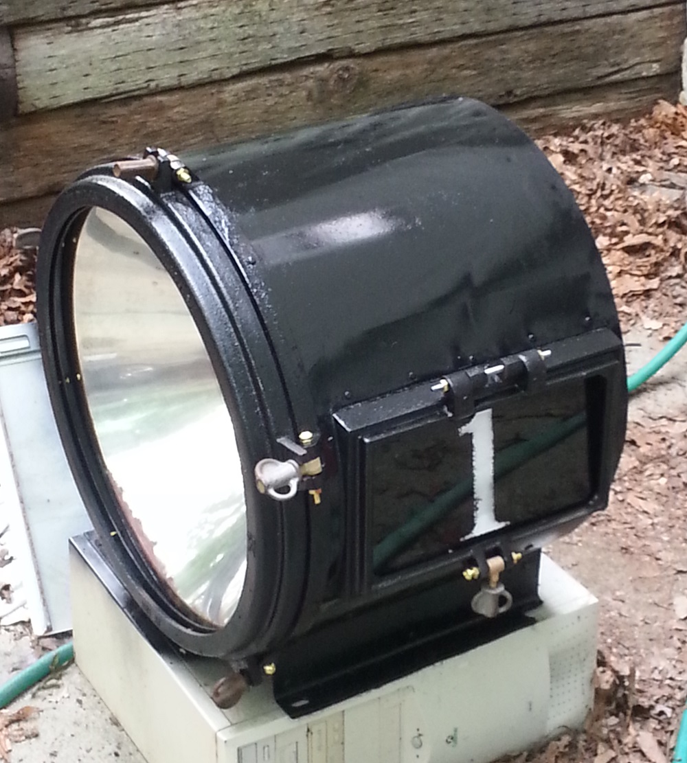

I have an 18" Pyle National headlight that I am starting to restore.
I got it long years ago while working at the Stone Mtn Scenic RR when we were cleaning out a bunch of old stuff.
I am positive that it was from SA&AP 60, although I am going to put it on RR&G 104 at the Southeastern Ry Museum when I finish.
The headlight is interesting in that it does not have a glass reflector. It is a spun brass reflector that has a silvered reflective surface.
I just got all of the hinge bolts and pins out and will replace these with brass stock once I bead blast the lens ring and number plate holders.
Kevin

Here is the Pyle National 18" so far.
Hopefully in a week or so, it will be mounted on the 4-4-0 (RR&G 104/Louisiana Eastern 1) at the Southeastern Railway Museum.
The number board is a temporary and another has already been made.

That is about a 1923-1930 version front cover, because the raised leteering on the front cover was not there in 1920. The side board bases are from about 1918-1923, as they are the version that is set inside the case. On the post-1920 version the number board bases are outside the case, see this #557; viewtopic.php?f=1&t=37103
Yours has the 1918-1926 number board doors, that have two lobes.
18" lights are super rare no matter their vintage, and I'd rather have a later one than an eariler one. Its a nice piece.
I'd like to measure your light some day. Maybe also 3D scan it.
My light from C&S #646 is identicle to yours in detail, only mine is the 14" version.
