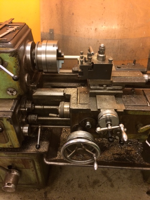

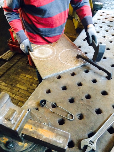

After the first day of formalities, this Saturday I was put straight to work! I started off by helping one member decide what piece of steel to use for the construction of a new lubricator stand inside the cab on the floor. We ended up deciding on a large and VERY heavy 15mm steel plate. After cutting off a smaller piece, we used an Accetalyne torch and burned out two round disks of the material. The pieces were chucked in an arbor on the lathe and we began turning them to the proper diameter. Unfortunately he left before we could get too much done, but I was soon given another project.

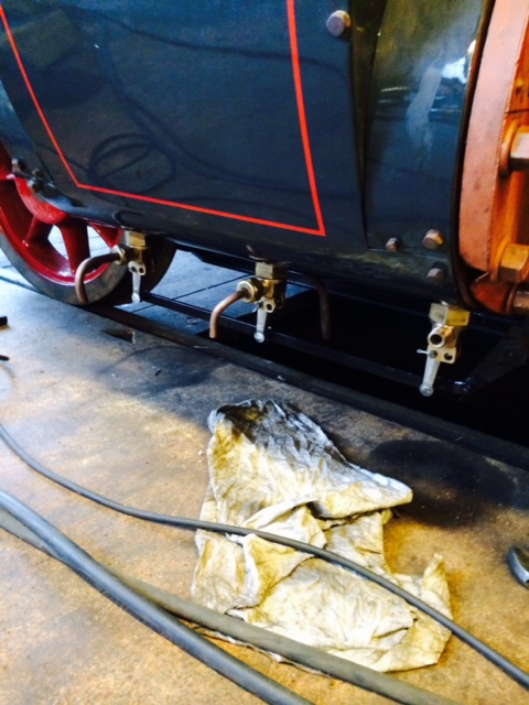

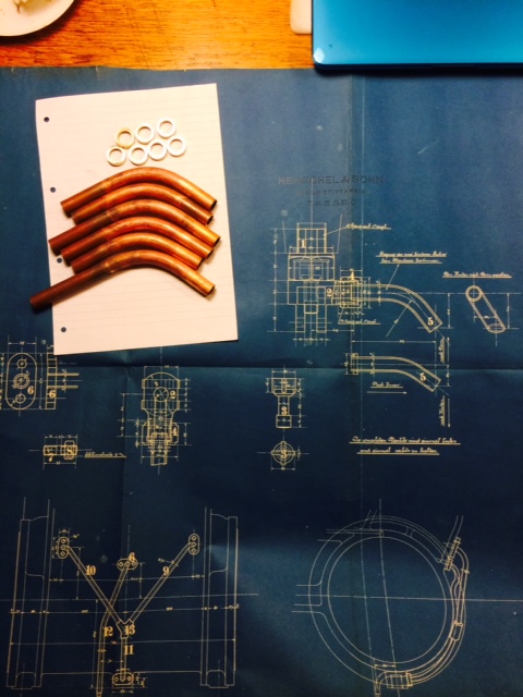

Some member in the past had gone against the lead member and the drawings, and made his own cylinder cock piping. The results were six different shaped and angled pipes that look very unruly. I was given the task of making six new ones based off of the drawing with some modifications allowed. After turning off seven nipple rings for the pipes, I got to work on the copper pipe. At first we couldnt find the small pipe bender, so a member and I worked as a team with the larger one to bend the copper pipe...the results did not come out well. Thankfully right before deciding to call it quits we managed to find the correct one. The results were much more beautiful and came out great! This Wednesday I will cut the pieces to the correct angles and lengths and then silver solder the nipple rings to the pipes. Hopefully this small but simple first project should be done very soon!

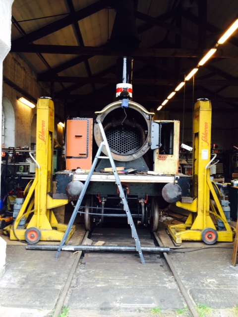

File comment: HHB #4 sitting in the right bay of the engine house

File comment: Front view of HHB #4

File comment: Knud clamping the piece of plate to the welding table

File comment: the former member's handy work with the cylinder cock pipes. They were bent in more than just the curve visible in the photo with many dents and flats spots. The other side was much worse!

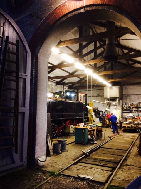

File comment: Turning the nipples on the lathe (tool was not engaged in cutting during the photo)

File comment: The result after a late night of work! Finally the copper bent at the correct angel with an even radius curve and without flat spots!
