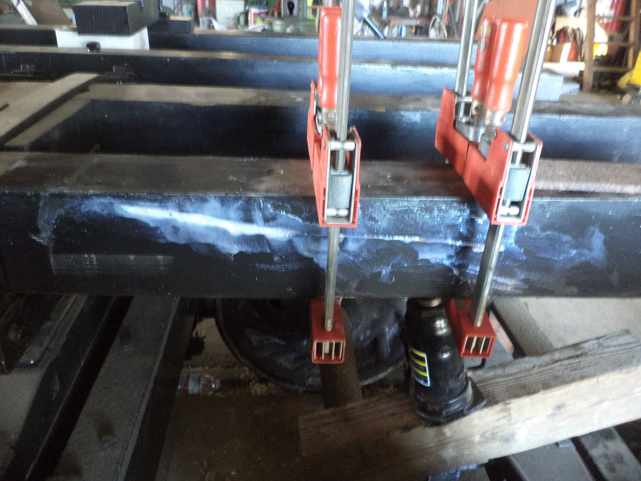

Gentlemen,
Thank you for your input. The photo shows the angled splice line and the repairs to the crack that developed on the left side. The original epoxy securing the splice actually gave way under the pressure used in the straightening attempts.

My inclination is to second Randy's suggestion about where and how to splice in new timber....and note that the epoxy isn't failing, the wood adjacent to the epoxy is failing if I'm understanding the situation correctly. Weak wood will fail next to a good epoxied joint or elsewhere. It seems you have ample evidence of this end of this timber being weak.....and it is possible the difference in strength and resiliency between the epoxy and the weak wood could provide a focus for future failures.

I'd be inclined to splice in a short length of new timber, but to use a stepped joint rather than an angled one. Mainly because it's a bit easier to keep everything square and level. As you attempted here, I'd use lots of epoxy and would be sorely tempted to sandwich the joint between two fairly long steel plates with a decent number of bolts.
Provided the crack that developed when you tried straightening the beam is in solid, clean, dry wood, I wouldn't be too bothered by excavating and filling with epoxy- just ensure the steel plates extend past that repair.
This doesn't appear to be a highly visible location, so the reinforcement shouldn't be much of an issue.

One issue I always take into account when planning wood car repair is the use... if the car will be stuffed and mounted, you don't have to address the dynamic forces from train operation, particularly the draft forces...
Since this car will see use, I think about using railroad practice instead of just gluing it back together... and railroad practice was a splice between the bolster and needle beam, with a z joint and a specified bolt pattern based on sill size (MCB practice)
Of course the railroad's didn't have epoxy available...
Adding epoxy to the MCB joint should make it better, and steel plates even more strength (and I have found wood frames reinforced with steel plates, making it railroad practice as well, just less documented railroad practice...) but with epoxy you have to consider whether the repair might be too rigid and therefore brittle and more subject to breakage. And in this case, the repaired beam was rigid and brittle enough to break when they tried to pull it into line...
When I use epoxy on wooden structural members I try to only consolidate or repair a part (like one sill, splicing, or adding dutchmen) making sure that all original joints are free, keeping the frame flexable in the ways it was designed to be.

I am not a big supporter of reenforcing wood timbers with steel plates. The wood and steel have differing strength and elasticity and will not share the load. If the connection between the wood and steel is adequate to transmit the forces into the steel, then the steel will carry all the load. Otherwise the joint will loosen up and wood will carry all the load.
The question of the epoxy's impact strength is a good one. I would be interested to know which filler you are using in the epoxy. Another problem with the epoxy is it deteriorates with time. It may have a structural life of twenty years. These would be good questions for the West application engineers.
On the long split I would suggest you add two lines of large vertical through bolts. The holes should be sized so the bolts have to be driven in. This will help prevent additional splitting and should act to carry the loads in the timber from one side of the failure to the other. The bolts need to be large not for their strength, but to give the wood enough cross section the carry the load. Do not put the bolts side by side, use a stitch pattern.
As far as is the car is safe to operate, I would think so. If this joint fails, there should be a slow deterioration of the joints, not a sudden failure. Many category one hazards have been converted to category three or four hazards by scheduling regular inspections.
If you splice in a new piece of wood with a long horizontal splice, I would recommend the use of trunion rings to reinforce the joint, in addition to the epoxy. The important issue in splicing in new wood is to find wood of sufficient quality to use as sill timbers. Finding good wood is probably going to be the toughest part of the whole project. I have the most luck with finding large old used timbers, and resawng them into what is needed. We find that wood cut prior to WWII is best. Due to the pressures of the war, a lot of wood was used that was considered to be temporary and it has not gotten any better with age.

My personal experience where wood is starting to fail is to soak the area with Git- Rot. It is a very thin epoxy that soaks into the grain and fills any tiny cracks. How long it will last is unknown to me. I have seen it last for 20 years in a wooden boat.
Git-Rot is available at most marine chandleries.

I donno, there was certainly enough wood truck beams and bolsters designed with iron "fitch plates", the idea being to combine the tensile strength of wrought iron with the compressive strength of a large wood section.
That being said, I see the ARA Mechanical Division (former MCB) standards for splicing wood sills, adopted 1911, as revised 1919, calls for reinforcing the splice with a wood member sistered on the side of the splice, this member to be the same depth as the sill, 6'-0" long, and either 2" thick (if oak) or 2-1/2" thick (if pine or fir). Since most sills are 4"-5" thick, this is essentially increasing the cross section by 50% through the spice, and should have similar properties of shrinkage and flexure.

I stand by my previous advise to splice between the bolster and needle beam, but I have a background concern about all of this...
I don't believe that any of these options have ever been subject to a calculation or review by a structural engineer... (If they have been, I would love to see that report)
Instead we are relaying on a traditional railroad approach... the design is traditional, the splice is traditional... Steel sistered to splices or to sills is traditional... These are techniques which evolved with practice to become MCB standards. the evolution consisted of trying various things, fixing what failed, retaining what worked...
Of the solutions we have discussed, only epoxy is a new player...
More than one educated person (aka holds a degree in engineering) have brought up the issues with steel and wood and how steel was attached if you were reinforcing the wood sill... suggesting that in addition to bolts you you should use liquid nails or equivalent construction adhesive to tie the two together and better transfer forces.
We are dealing with traditional seat of the pants solutions... but fewer and fewer of us have the first person experience that old Master Car Builders did... we have the advantage of being able to study their solutions, but the solutions are still theirs, and sadly their voices are not part of the discussion...
