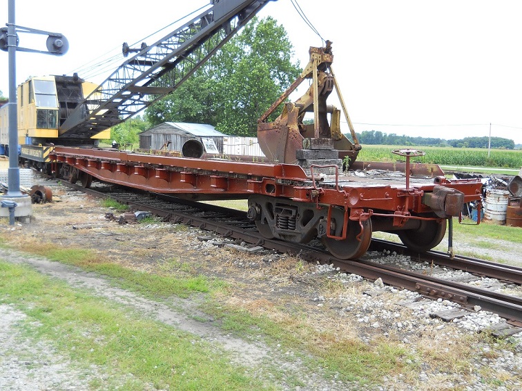

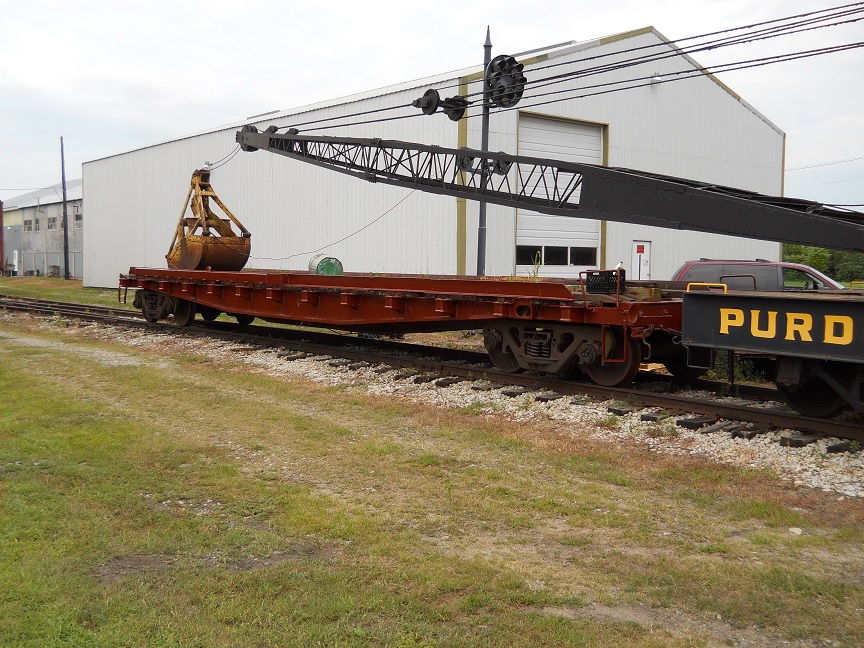

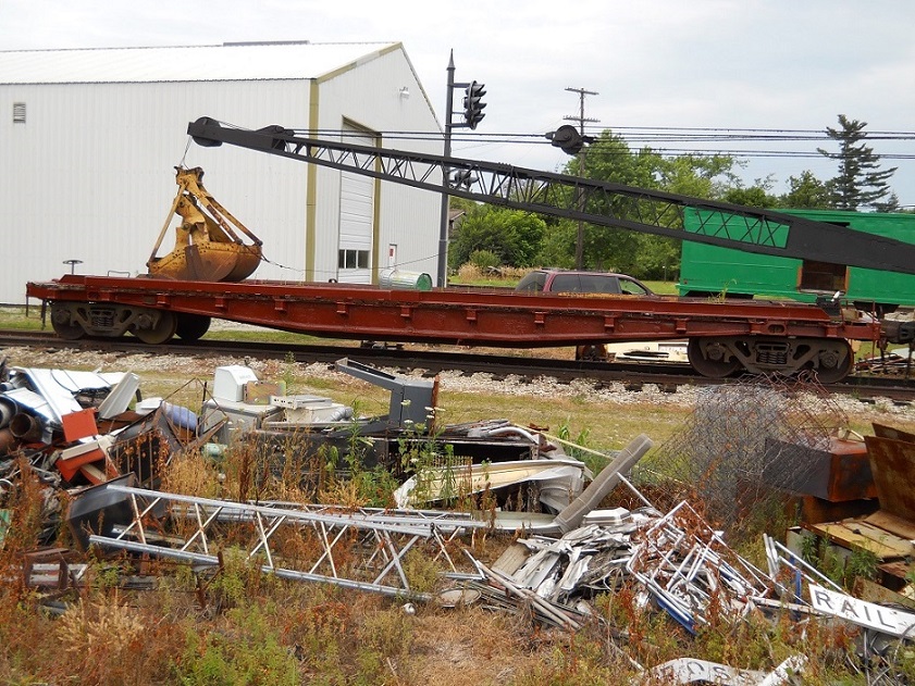

When the Pennsylvania Railroad introduced its piggyback program with its TrucTrain service back in 1954, it was started with the conversion of 90 F30d class flat cars. This was increased the next year with the addition of 25 more F30d's, or a total of 115 cars. During 1957 and 1958, 86 of these F30d's were transferred to the Trailer Train Company when that company came into existence. Our museum has one of these original F30d class Trailer Train flatcars, number 475037. We have long thought that we might convert this car back to its original Pennsy configuration before its piggyback service, although we were never able to find the original PRR number for the car. Recently however, we have decided to try to restore the car to its original 1957/58 configuration as best we can, and re-letter it back as TTX 475037. Along those lines, we have removed some of the additional steel work dating to a 1981/1982 upgrade and recently repainted the car into its freight car (Tuscan) red paint. Some photos are included below. We need some help with this project, and I'll send another entry with that explanation.

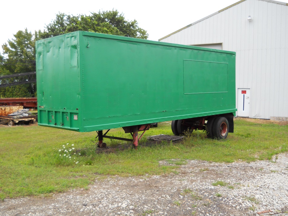

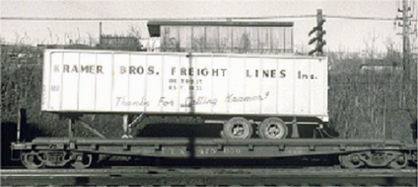

The plan with this project is to mount our REA trailer on this car. A photo of it is included below. Tom Travis of our museum has painted the body but it still needs more work, including the addition of red paint, Railway Express Agency logos, door repair and (hopefully) some authentic advertising signs for both sides.
Also needed with be two bridge plates; one for each end of the car, to duplicate the old "circus" loading. The plan is to weld these plates in the upright position as we do not intend to unload the trailer after it is set onto the car. We have been told that these original bridge plates were the same as for F39 class TTX long flats, and we have been given a drawing, also shown below. If anyone knows of the whereabouts of genuine bridge plates, we would like to know so that we could mount them on the car. If we can't find any, we will replicate the bridge plates with flat steel.
Finally, we are also enclosing a photo of sister TTX flat car number 475056 show a Kramer Bros. trailer mounted on the car. We need to find the original lettering for the car as shown on 475056. If anyone can furnish that lettering diagram so that we can make stencils, we would be most appreciative.

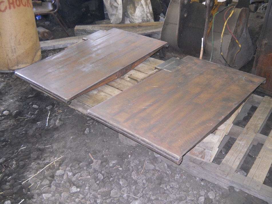

PostPosted: Fri Aug 15, 2014 6:41 pm

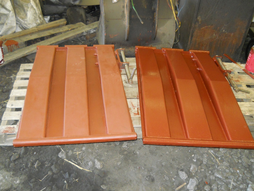

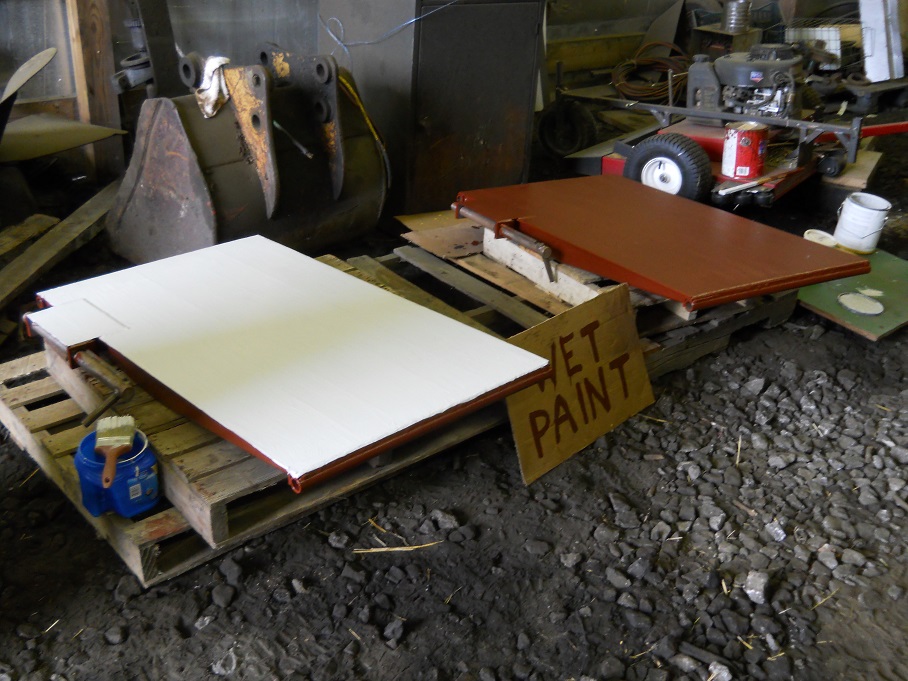

I guess I have been very lax on this thread. I got a note from Jim Panza today, that made me realize it. More on that note in a moment, but first, some info. Jim used to work for TTX and was instrumental a while back in finding a company that agreed to make duplicates of the two bridge plates for this car and eventually they were delivered to HVRM. They are beautiful, and may even be nicer than the originals! I have been slowly painting them over a period of time and I'm going to try to post photos herein. PROVIDING I have them in the right sequence, the first photo shows the plates after they were received and in their bare metal state and the second one shows one in primer and one in the finished Freight Car Red. On a visit to IRM over Father's Day weekend, I was startled to see that their TOFC car had one white side and Jim confirmed that this is the way they were painted so that the truck drivers could more readily see the bridge plates as they loaded or unloaded the trailers from the cars. So the 3rd photo in the sequence shows one of the bridge plates so painted.
As I said, I got a note from Jim earlier today and he advised me that in checking some old company records, he actually found the original Pennsylvania Railroad F30D car number! TTX #475037 was once PRR #475403. Although we now have the Pennsy car number, we are going to go ahead and restore this car as TTX 475037!
