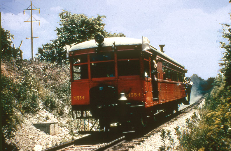

I rode this car from Frankfort to Louisville when it was donated to KRM (in 1959, I think). Here's a photo from that trip.
-Jim Herron
