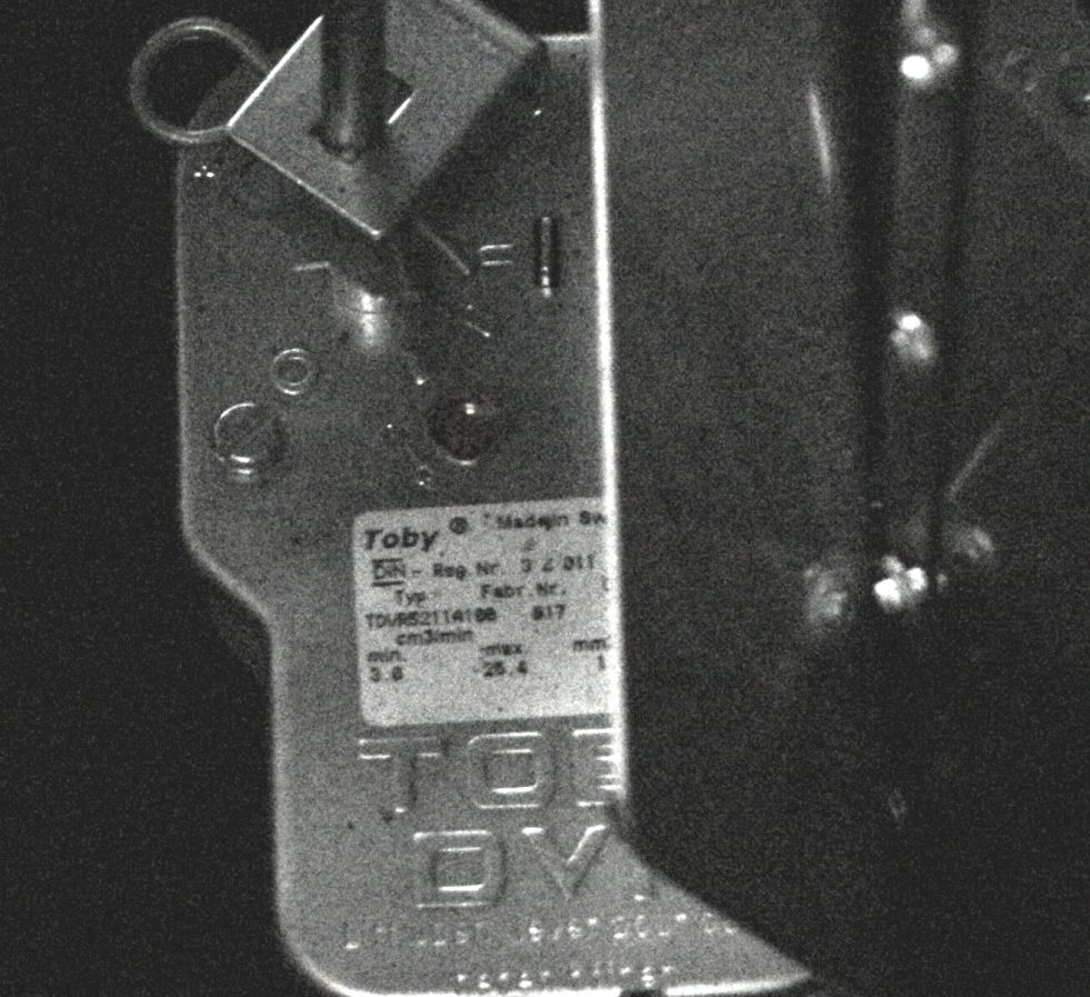

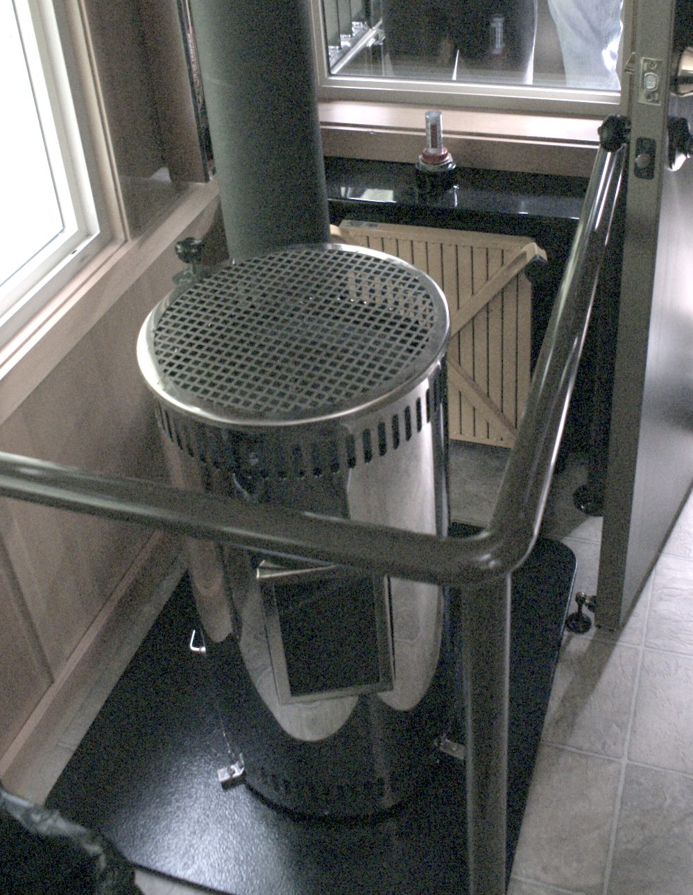

Oil is a good option for rail use. Less explosive than propane and less expensive per BTU. White pass and Yukon was using Nordic 6800 series stoves for car heat.
https://www.ruralenergy.com/heating-equ ... 800-series
I was curious to take a photo of the stove and Toby burner control when there. Possibly Toby makes a refit burner.
