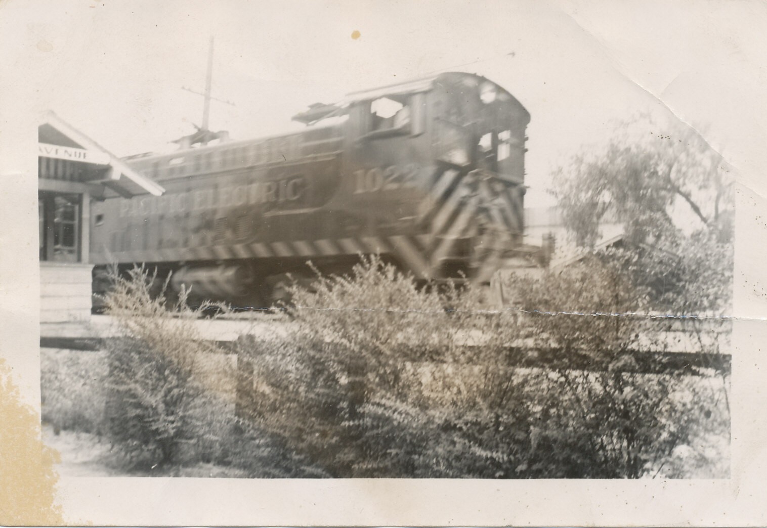

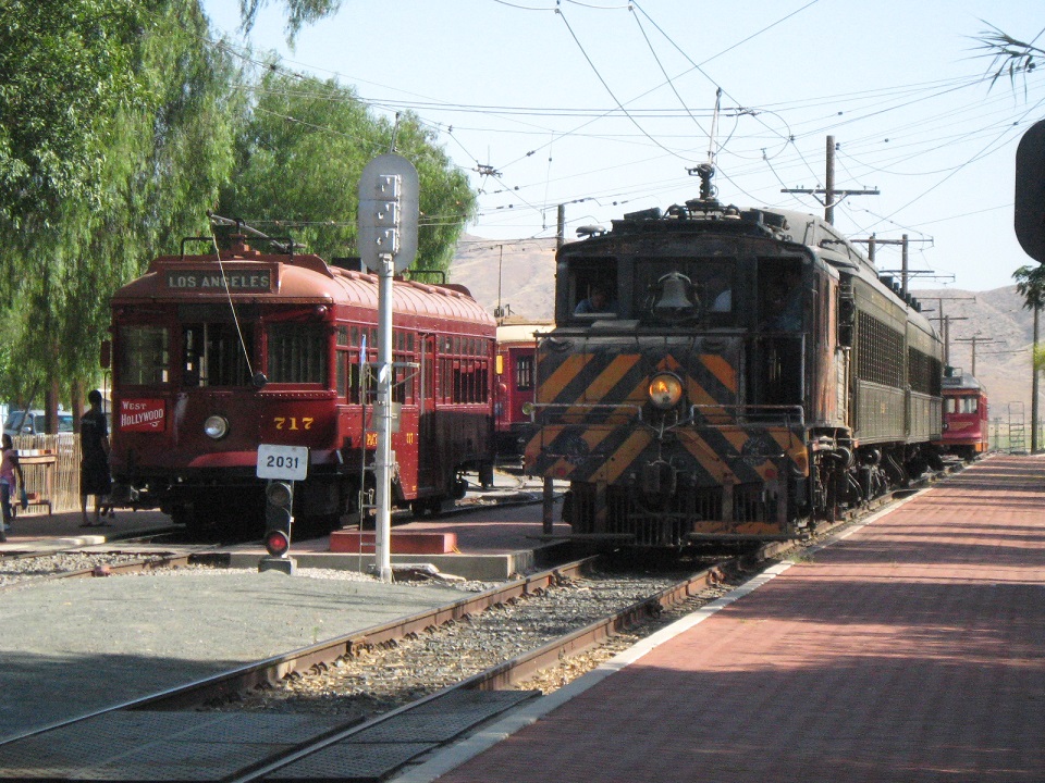

The Pacific Electric line that ran past my home in Monrovia (until 1951) had freight trains, box motors, interurban cars, and for the last six month before abandonment, Hollywood car runing on the same tracks day and night.
1) Hollywood car 717 and PE "home-brew" freight motor 1624 at Orange Empire.
2) Baldwin VO-660 on the PE gravel train westbound through Monrovia, 1950 or 51. There would have been passenger runs before and after this train.
