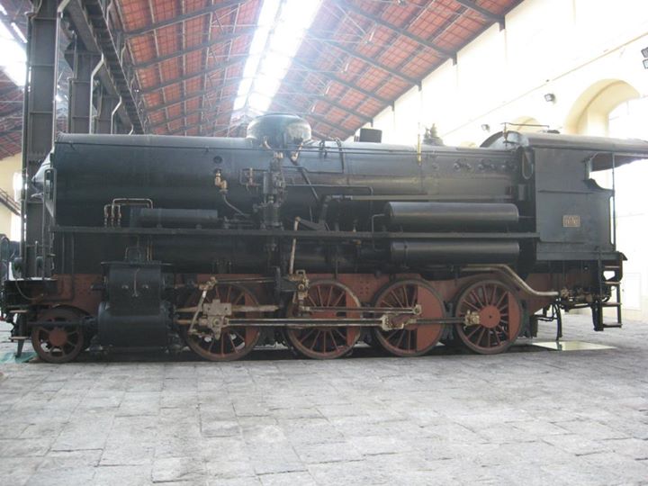

More then one. This one is at the railway museum in Pietrarsa, just south of Naples.

Definitely an interesting design for sure! I am guessing that it has problems ejecting the ash from the boiler, hence the new location of the stack and the longer path it has to travel. Would this make the second door beneath the smoke box door specifically for removing the ash that collects in some special ash hopper?
