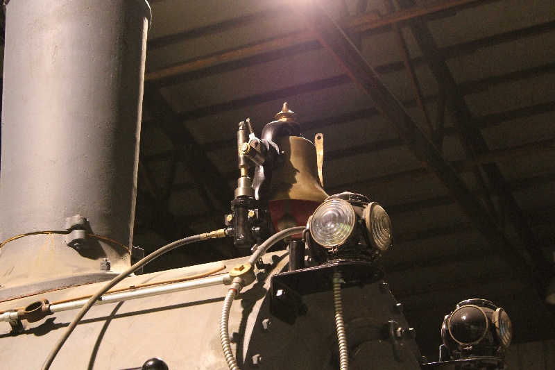

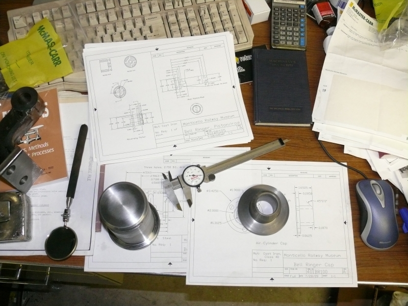

Location: Monticello, IL
Here is what we did at Monticello, no CNC required. We found one to borrow as a pattern, measured it up and made the parts. Also did some scaling out of the cyclopedia. As Kelly noted, they are very simple, and ours, after some initial fiddling and adjusting, has been pretty much trouble free... so far. Every now and then it won't start as it is stuck on center, but a quick tug of the rope starts it right up. We have not had to change the adjustment since the initial tuning up, but then we only run during warm weather.
File comment: Bell ringer parts in process.
File comment: Bell ringer mounted to bell during testing, note the air hose connected directly to the ringer.
Years ago we tried a diesel ringer in a steam loco bell, and the problem with that is the clapper length is designed for the much smaller bell found on diesels. This put the clapper way up inside the larger bell, with the clapper not striking the rim of the bell, but the side. While it did ring, it didn't sound right.
