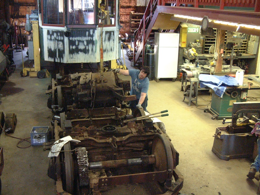

The winter of 2014 has been one to remember. For 45+ days in most of February and March, there was so much snow on the ground in East Haven that we couldn’t move any equipment except on the mainline and out of one operating carbarn. The trackway doors on each building swing out, and there was just too much snow to be able to open them.

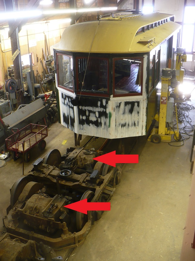

Fortunately, the spring thaw began in mid-March, which finally allowed us access to all of the buildings. On March 23, a weekend crew switched car 302 out from its winter storage and restoration spot on track 72 in Barn 7 and rearranged cars in the shop to move the mail car into position for the work to begin. The first stop was on the pit track, where motor repair contractor and BERA member Joey M. tagged and disconnected the motor leads on all 4 Westinghouse 101 traction motors, and disconnected the brake rigging. Another switching move was performed and the car was moved from the pit to the east end of the shop on the floor track, where the car would be lifted.

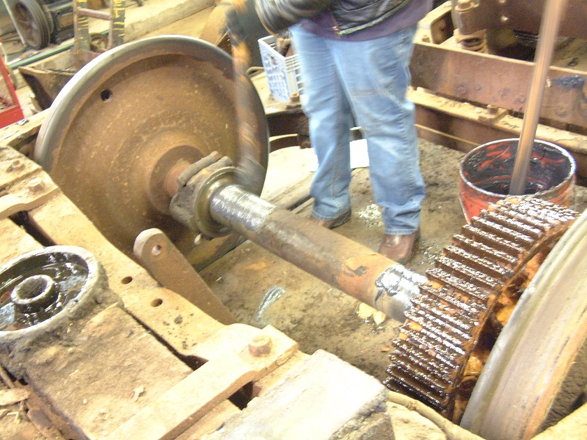

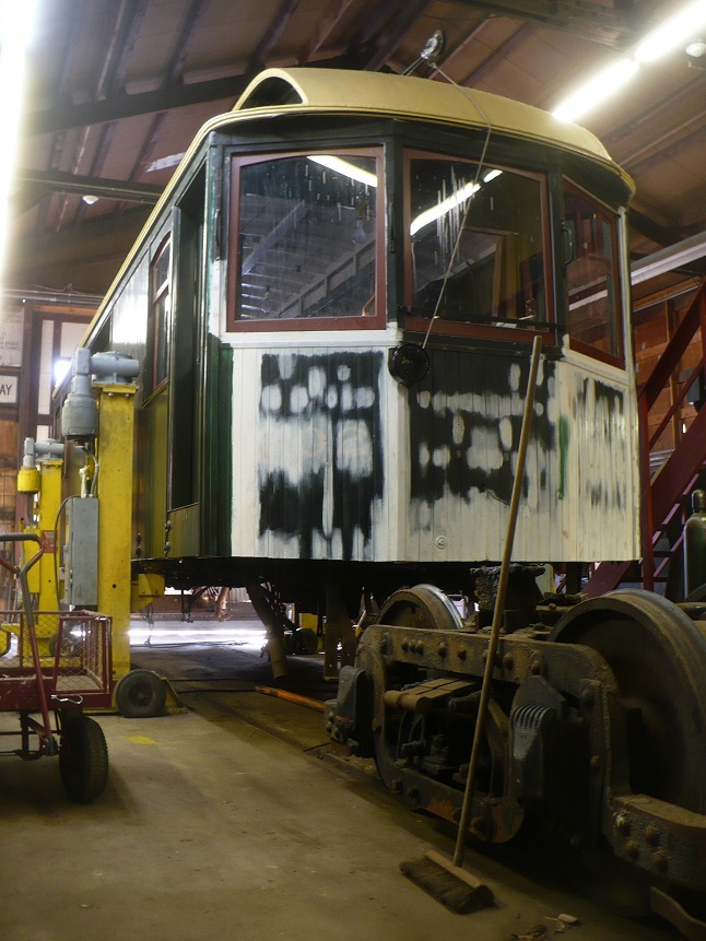

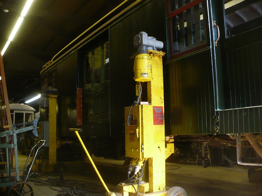

Later that day, with the 4 electric car jacks in position, car 302 was lifted off its trucks for the first time in we’re-not-sure-how-many-years. The two trucks were rolled out from under the car to a spot near the shop crane. Axle caps were removed and the gears were lubricated. The position and mounting of each motor was marked in the shop journal and the position stamped on each motor so all will return to their original location upon overhaul.
Please see the following photos of recent progress:
File comment: Four 15-ton electric car jacks do the heavy work in the shop.
File comment: RPO 302 fully elevated with trucks rolled forward.
File comment: Arrows notate the traction motors mounted on one truck.

File comment: Applying grease to the axle bearing surfaces.
small3858 Applying grease to the axle bearing surfaces to prevent further oxidation while axles are bare.jpg
small3858 Applying grease to the axle bearing surfaces to prevent further oxidation while axles are bare.jpg [ 257.45 KiB | Viewed 3677 times ]

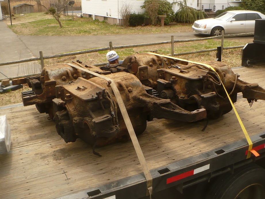

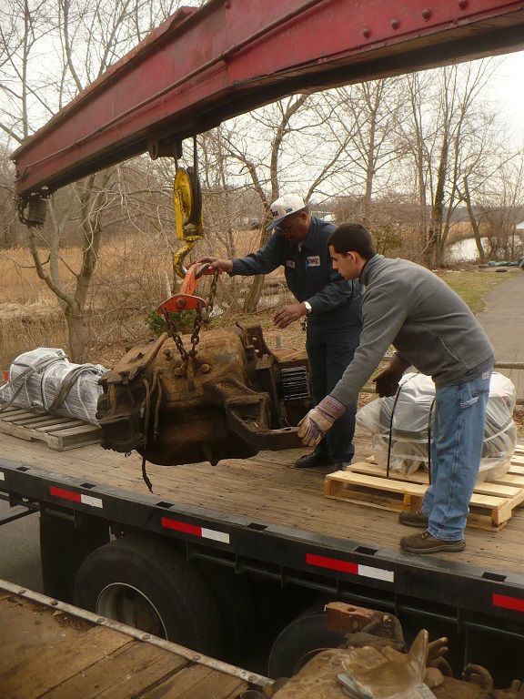

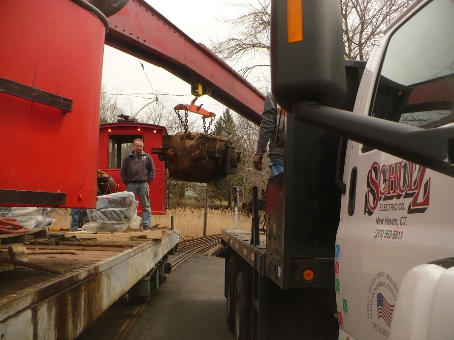

Schulz Electric (New Haven, CT) is our motor repair contractor. On April 11, the four motors from 302 were loaded aboard the deck of our Montreal crane W-3 for the journey to the end of the line at Sprague Station. Here, they were transferred to a Schulz truck which took them to the shop for the overhaul work to begin. In the same delivery, Schulz returned to the museum two freshly overhauled WH510 motors and a motor generator unit from other equipment which was flood-damaged. We expect 302’s motors to require several months at Schulz and will provide another update at that time.
File comment: A one motor is lifted from the crane deck to the truck deck. On the truck deck, overhauled traction motors are being returned to the museum for other equipment.
File comment: Crane W-3 lifts one traction motor from the deck of the crane to the deck of the delivery truck.
File comment: 4 Westinghouse 101 motors loaded and ready for transport to the motor shop.
