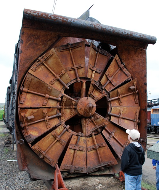

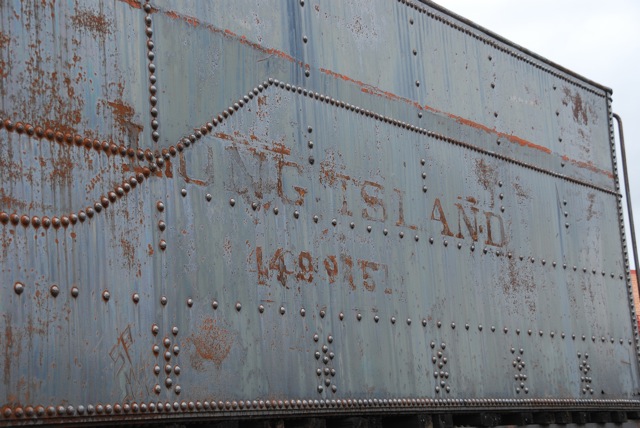

Some exterior shots from May, 2011.

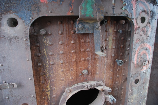

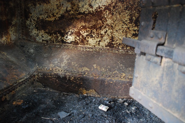

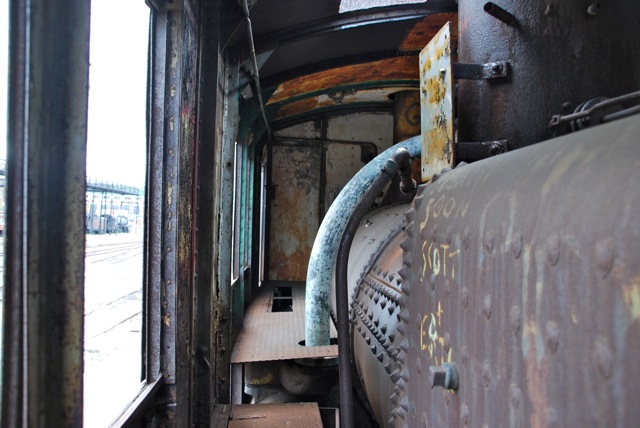

Some interior shots from May, 2011.

Sure looks like a Belpaire firebox to me. Perhaps she was refitted with a pennsy boiler some time during her long life.
 Post subject: Re: LIRR steam rotary at Steamtown
PostPosted: Tue Apr 01, 2014 3:59 pm
Posts: 550
I was thinking the same thing myself. The rotary is a Cooke product of 1898, and a Belpaire firebox just doesn't sound right for Cooke.
Perhaps a comparison with the White Pass & Yukon's 1899 Cooke rotary could shed some light on this.
Alternatively, do the dimensions of the boiler match those of any standard Pennsy designs?
PostPosted: Tue Apr 01, 2014 4:24 pm
The rotary was re-boilered at some point during its life on the LIRR. The original tender was replaced with a PRR design tender with Dolphin trucks. It might be an old E6s tender, but I think the conversion was done in the thirties, just about the time LIRR was dropping their H6sb fleet. This is from memory, so I may be wrong about dates.
