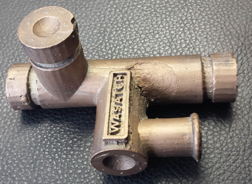

Now, before we all get big ideas about 3D printing, we need to all take a small step back. The 3D printing we do is made by a printer that prints in one media....a plastic type of media.
Printing money is a different media. Money is made primarily of cotton, right. So, until we have the technology to do 3D printing that includes, cotton, paper, ink, and other medias all in one, 3D printing of money is out. For that matter, doing 3D printing of glass and other items is out until they come up with the technology to print in that media.
We use the technology to sample a design before we actually make something. Included is a photo of a 3/8 inch injector body that we are working on. This first casting is rough, but it shows the 3D printed mold fairly well. If you look closely enough at the photo, you will see lines in the casting. These lines came from the 3D printed part that was used as the pattern. The resolution on our 3D part was not the best. The name plate, which was also a 3D printed piece turned out well.
The purpose of this project was that of determining if 3D lost wax molding would be good enough to produce multiple injector bodies in one pour. Indeed, our trial worked and we are now in the further stages of finishing this injector project and selling these injectors.
A lot of areas of manufacturing are using 3D to print items for trial and or testing or as mock-ups to what a actual piece would be. We at Wasatch are doing it and I believe that 3D will be a substantial part of future restoration work.
