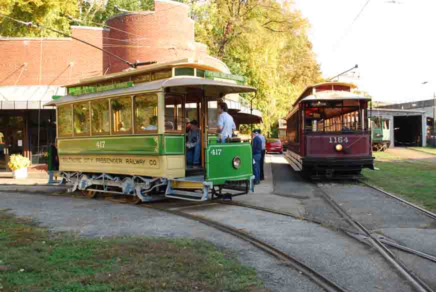

(weird aside… The Baltimore Trolley Museum chooses to run their very old wooden car rather than their steel PCC cars… their line crosses a road to Baltimore road salt warehouse, and salt and rust is an issue… so for them, wood works…)
First, it's the Baltimore Streetcar Museum, in recognition of the fact that "streetcar" was part of the locally used vernacular.
Second, while that may or may not have been true a while back, that's no longer the case today. When the collection was 100% Baltimore cars, there were only two "metal" cars in the fleet, Peter Witt 6119 and PCC 7407, and both were/are essentially "one of a kind". Now that the collection includes a beautifully restored Philadelphia PCC, a "spare parts" PCC overhead line car, and a waiting-to-resume-service Newark PCC, there are "expendable" metal cars in the fleet that aren't unique Baltimore artifacts, and the wear can be reduced on 7407 if they wish. And I've never heard the salt at the Ma & Pa roundhouse being considered as a factor in operations. (Now, the salt that the city's overloaded trucks spilled in their parking spaces to speed-bump sizes, that's another matter--anyone want to make a LOT of ice cream this summer? Come on down with a bucket and shovel--still hundreds of pounds left!)
And the BSM rosters several "very old wooden" cars, not just one, including recently newly restored Baltimore City Passenger Railway 417, a single-truck car which originally saw horse power.
(Disclaimer: My views are observations only, and do not reflect any official BSM policy if such even exists, save for the name correction.)
