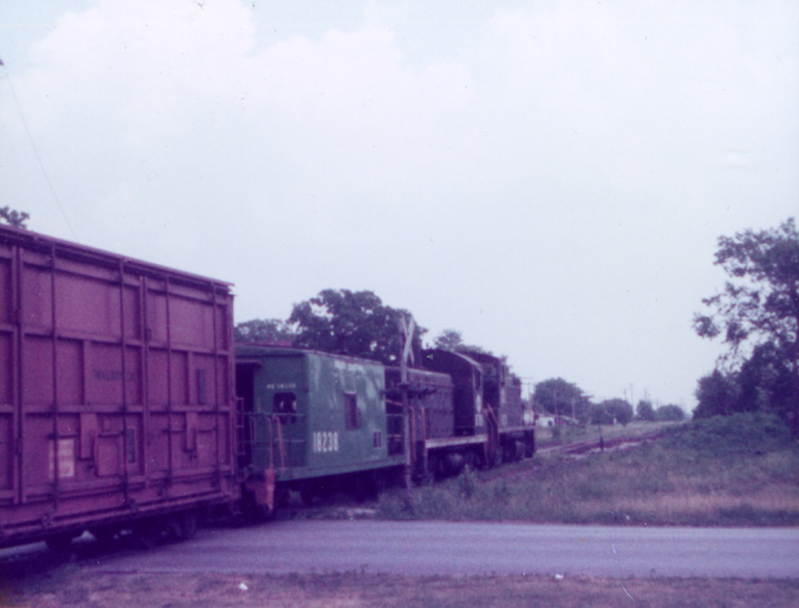

FEC ditched them in the sixties and if not for labor agreements and politics so could the rest of the industry except where having them actually makes the work more efficient.
This one was just in the way on this Conrail branch run with just a few cars (operated with IHB power).
Steve
