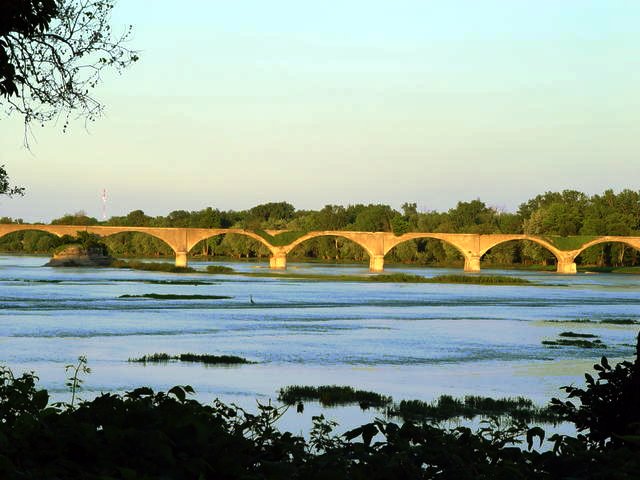

Also, the Ohio Interurban Bridge... http://bridgehunter.com/oh/lucas/interurban/
