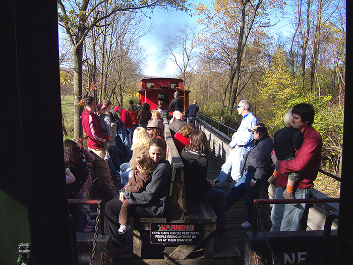

I look at a lot of railroad museums, and I ain't bragging. Far and away the best open car that I have ever seen is the 65' pipe gon at the Southern Michigan Railroad.
http://www.flickr.com/photos/daverodriguez/4041145208/
The car feels organic, unique and fun, while retaining a sense of the historic purpose of the car. It's easy to keep up and the sight lines are best in the business.
It was done in the infancy of the organization, and like anything it was hit and miss, but here are the hits IMO.
Prep: Sandblasted down to white metal, quality alkyd primer and paint. Lasted about 20 years. Would last a lot longer with epoxy primer/Amerlock etc. under LPU paint.
Decking: 2x6 stringers leveled on the gondola bottom then 2x6 decking. The comment of the day was "built for elephants" but it has held up.
Seating: A-frame bench seating down the middle, looking sideways, 3 blocks of 16 feet each, with gaps between. (our rule of thumb is 60 seats at max capacity.) The only downside to this is it's difficult to move through the train taking tickets because you have two aisles to work. I would recommend offsetting the bench seats 2-3" off center so one aisle is wider; that would become the conductor path.
Wood: old-school wolmanized. The car just cleared its 26th year of service with original wood. Most wood is still serviceable but the passenger seat bottoms are about done for. (the floor is in same condition but that's OK for a floor.)
TREX: We debated retrofitting the car with plastic lumber (Trex), but the deal-breaker was the stringers are too far apart. (Trex is saggy and requires more support.) I like the organic feel of real wood, but nobody looks at seat bottoms and that's where it matters most.
Post-rain use: After a rainstorm the car seats are very wet and the wet wood soaks into people's butts. Not happy about that part. Have lots of towels/blankets on board. This is one place painting or Trex would help.
Egress: Don't even bother. Have people walk thorugh from an adjacent coach. First few years we used a caboose for that.
End access: tough problem, look elsewhere for a good solution. I like what CSRM did.
Lettering: I don't like the "not historically accurate" aspect of this, but billboard lettering on the side of the gon makes groups LOVE to get pictures in front of it.
HudsonL. Sand and paint: Disagree. We never did and never had a problem. If you're that worried about it, go Trex and bedone with it.
Bare wood is fairly maintenance-free. Once you paint it, the paint will deteriorate and you'll have to repaint it often, because of butt wear. Repainting is a significant chore because of all the darn prep.
Paint on fresh lumber will fail. (well, housepaint will stick, but it is very fragile and won't hold up to butts.) So you'll either need to stack your wood for a couple years to weather/dry/stabilize, or go bare for that long.
Robby, lots of outfits both on and off general system have open-air cars fashioned from freight cars. Tourist railroads are always exempt from 238 and 239. Freight cars converted into passenger service also drop off a number of freight regs, since they are not in "revenue freight or work train" service. They're in kind of a regulatory limbo.

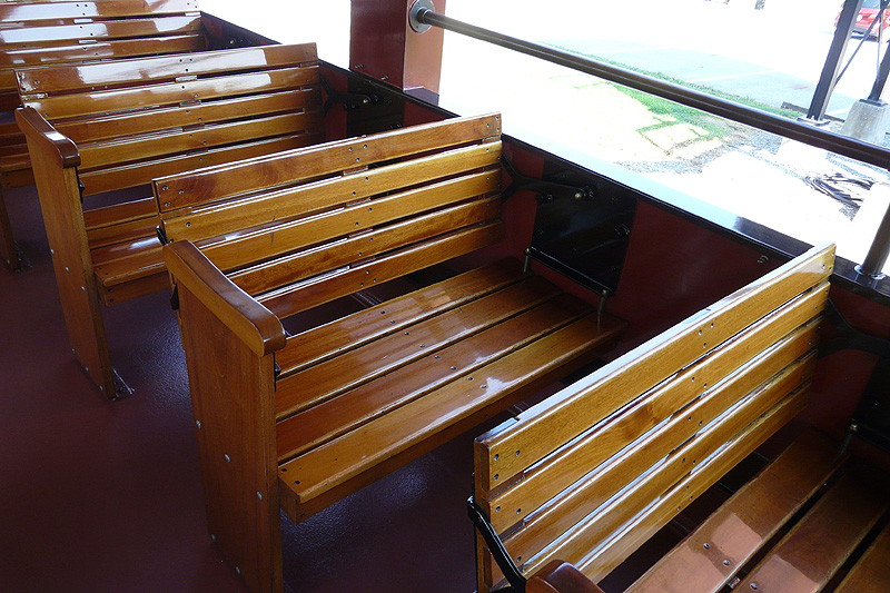

If you have a low sided gon, make sure to add a safety rail around the top, so nobody goes backwards overboard.
Personally, I don't care for center bench seating, which is awkward for both passengers and crew. Strasburg came up with a basic wood walkover seat that seems ideal for the purpose and doesn't restrict passengers to one side view.
Alan Maples
File comment: Wanamaker, Kempton & Southern.

The Wanamaker and Southern gondola is what the southern michigan railroad's gondola looks like most nice days. Like I say people absolutely love it, and it is far nicer than the cars with canopies (noting that a steam engine is not involved.) It does create a dilemma with advance sale of tickets, because any seat you pre-sell, you need a "plan B" in case it rains.
Forward facing seats probably would add 30% to the seating capacity of the car. But they are either facing backward half the time, or phenomenally hard to build (walkover seats), only a few museums can make those. And even worse, you can't use burly wolmanized 2x6's for the seatbacks, you have to use more delicate fare, and that means you'll need a carbarn to keep the car in.
So I like sideways bench seating because it's easier to build and maintain, fun and unique. You see all those standees in the above pictures, they're having a whale of a time, and you don't see any at all in the cars with normal coach-style seating. I suppose it depends on your opinion of the safety of standees.
