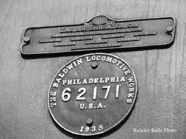

 Post subject: Re: Those Superheater Corporation Patent Plates
PostPosted: Wed Mar 05, 2014 11:28 pm
Posts: 2112
SP&S #700 has a Superheater plate:
Ted Brumberg
PostPosted: Thu Mar 06, 2014 8:39 am
Interesting that the builder's plate has no month on it, just the year. Is it an original or a repro?

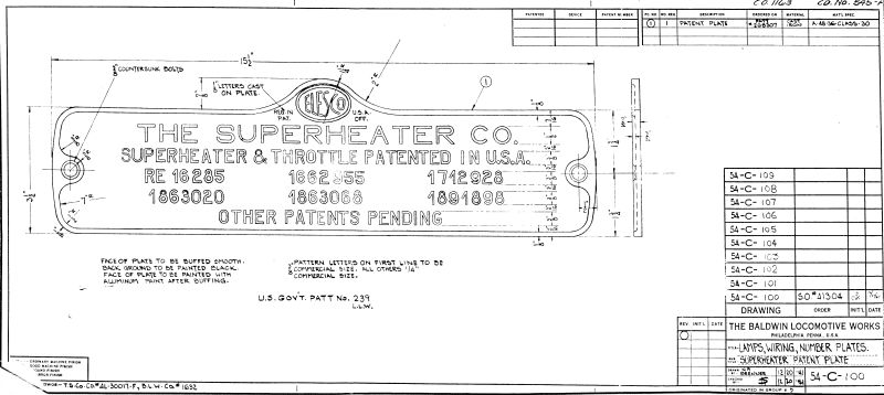

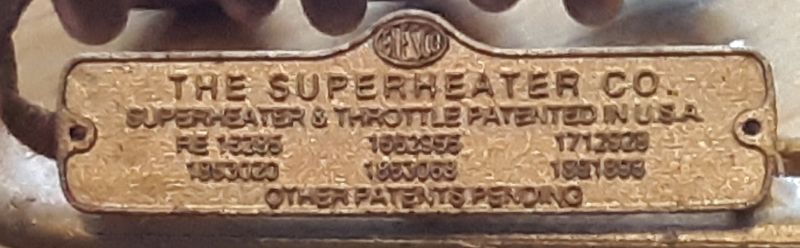

PostPosted: Sun Aug 06, 2023 4:59 am
Posts: 704
Location: Anchorage, Alaska
For a 1/8 scale 1944 vintage USATC Consolidation I am building I wanted an Elesco patent plate. So I used the drawing specified for the locomotive in the Baldwin card index to model it in 3D cad, printed it on a 3D printer, and investment cast it. I was disappointed when I compared it to the plate that came off of the prototype locomotive. That plate only had a single patent number, not several as indicated in the drawing. The drawing says that Elesco provided the patent plates and my guess is that most of the patents ran out between the time the drawing was done and 1944, when the locomotive was built. Since Baldwin wasn't providing the plates they must have thought it wasn't
important to update the drawing.
