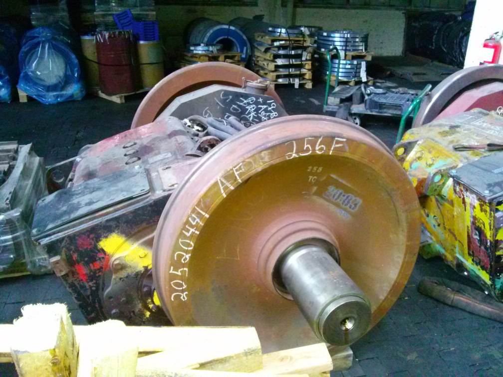

The slight groove around the edge of the rim, just inboard of the point the wheel "breaks" to curve toward the wheel center, is the witness groove. In the photo, it passes though the lower part of the chalked numbers/letters.
