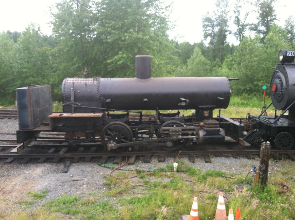

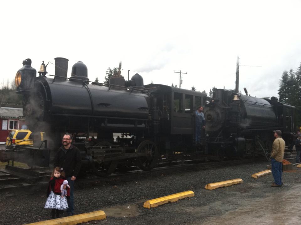

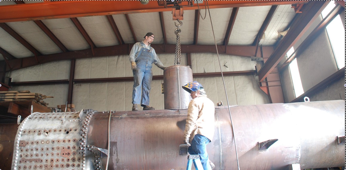

I'm with Kelly on this one! There are lots of talented steam men and women out there, we are actually very fortunate in this country to have so many.
