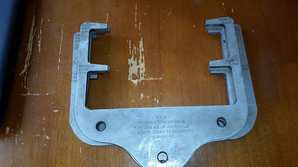

Questions regarding fitting brasses to passenger car axle journals in situ, without removing the wheelset from the journal boxes:
- Does anyone have "tuning fork" gauges (see attached photo) to measure actual journal diameter (nominally 5-1/2") while still inside the journal box?
- Does anyone have a set of dummy axle journals to fit brasses to, for the range allowed by the spec for 5-1/2 x 10 journals?
If you have something we could borrow for a week or so, please contact me. We'd be glad to pay for boxing, shipping & handling.

That looks like more of a go/no go or use/condemn gauge (pass through the first point is new size, second point is condemn the axle as too worn.

The legs of a typical set of calipers won't fit inside a journal box when open, hence the "tuning fork" design.
Doug: we have a set of these and would be pleased to lend them.
J.David
PS: I have never seen or heard of "dummy axles"... JDC

Thanks to this thread I now know what these are for. They have been in my office ever since I got them off the P&LE in the mid 90s. Never really paid much attention to what they were. 5x9, 5 1/2 x 10 and 6 1/2 x 12 sizes.

Of course, you can always use the "tuning fork" gage and a feeler gage to measure the size within a thousandth... plenty close enough for this class of bearing.

There is no need to be that picky. Note that 5-1/2” journals can turned down to 5.125, and operated down to 5.000 dia, and when 5-1/2" brasses were being mass produced, they only came in two sizes, 5.515 bore and 5.390 bore. The only requirement was to not put a brass in place that was smaller than the journal. It was and is permissible to mount a 5.515 brass on a 5.000 journal*. Accordingly, the go-no go gages shown are perfectly satisfactory. Rest assured that the railroads didn't custom fit every brass to a particular journal.
*Although having the brass fitting closer to the journal will result is a cooler running journal, all things being equal.

SRC has an empirically-derived plain bearing car journal protocol where the journal is measured with friction calipers diagonally in the box opening without removing anything. The replacement bearing babbitt is custom fly-cut 0.015 larger. This dimension has given the lowest average heat across a range of journal sizes and axle loadings.
The old go, no-go gauges are anachronistic.
