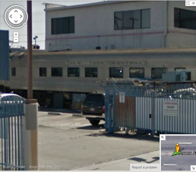

Author:  Brian Norden [ Mon Feb 17, 2014 1:48 am ]
Post subject:  Re: Budd Observation Cars
I need to verify if this car is still here. This Google Map street view in from 2011 -- it has been at the location for some time.
This location is about half block east of Alameda Street.
Here is another view -- looks like the car is still up on trucks. But it has a door cut into the side of the lounge.
This may be the same one that first arrived in the greater Los Angeles area sometime in the 1970s

Author:  jmlaboda [ Mon Feb 17, 2014 4:04 pm ]
The car was stored for a time in 1978 on the Los Angeles Jct. Rwy., I was there when it first was brought on the line and weeks later when it was stored on an unused industrial siding with the passenger cars acquired by Los Angeles County. Wish I had a camera but then would have lost then anyways in a forest fire in 1985 when my mother's trailer burned down.
