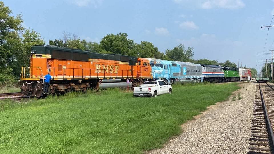

This unit still has stainless steel handrails on the pilot under the paint, from the time when the BN president was using it on office car specials. Speaking of which, I recall the paint scheme these units were delivered in being called appropriate for a jar of hand cream, not a locomotive, I believe the guy at that time was from an airline. Trains magazine called these the best locomotives on the market back then, the main problem IRM will likely have will be with the early-90s electronics. Christian James photo, click to expand.
526523754_122271866738200742_7108347073717859501_n.jpg [ 160.2 KiB | Viewed 42996 times ]
