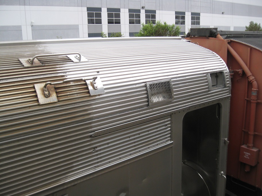

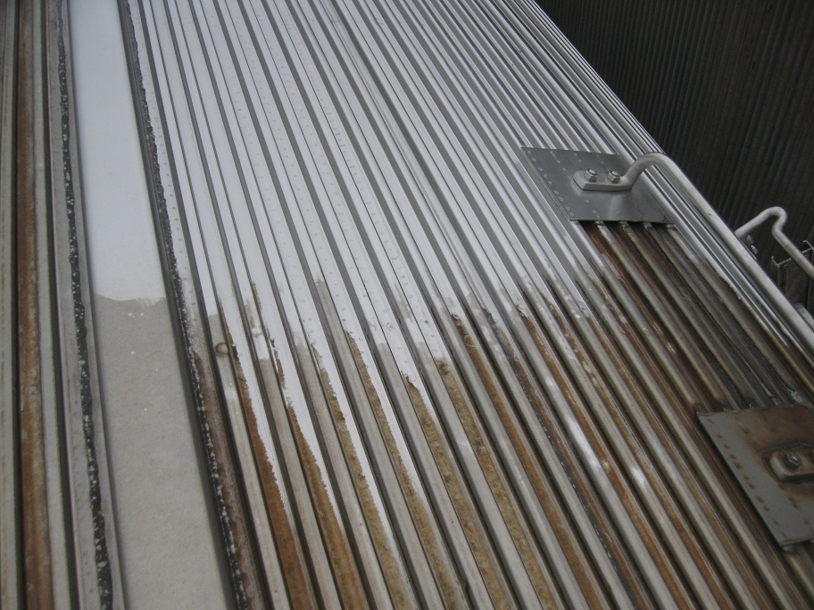

I agree with several of the other posts. I have used an aluminum brightener as an acid wash on stainless cars for years. There are any number of makes out there – which one you use is probably not critical. The finished result after using this stuff is unbelievable – like brand-new stainless steel (unfortunately though, it won't remove the dents). I use it full strength for the initial “20 year” cleaning. Anything less than that just isn't really strong enough to remove the heavy surface rust. And as others have correctly noted, this stuff is very strong, so you must not leave it on more than 5 or 6 minutes +/-. Also, use rubber gloves and eye protection. It will start to eat holes in your clothes a few weeks afterward, so don't wear your best T shirt and jeans. You will develop a feel for how long you can keep brushing it on before you need to hose it off. You can do a given area several times as-needed, but never leave it on too long during a given application or, as noted by others, it really will etch the stainless. And always rinse the area thoroughly, soaking it with lots of water after each application.
An acid wash will rarely remove paint, though it will discolor it. Sometimes I will do an initial acid wash first, to help me see where I need to paint strip. After paint stripping, I will go back with another pass or two of the aluminum brightener to finish the job.
Also as noted previously, most of these acids do not work well on a warm/hot day or in direct sunlight as the acid will dry much too quickly and then you are screwed. Best to apply early in the morning or on an overcast day.
I ordered some more acid recently and my brand comes in 5 gallon pails with a 15 gallon minimum order. Total cost delivered is under $300.00 dollars.
A diluted mix of the acid can be used after the big initial cleaning every few years or so to keep the car looking nice. This reduced mix might be on the order of 50/50 water to acid.
Acid washing your stainless steel can actually be a fun process because the end result can be seen fairly quickly and the cleaned stainless is so unbelievable compared to what you have when you start.
The pictures show an example of an acid wash in progress I did a few months ago. As can be seen, there is s pretty big difference in the before vs after.
As a final note, I would never polish a stainless car. In my opinion, this makes the car look way too shiny, and I don't think they ever looked like they had a mirror finish. Not to mention that polishing something that big is a ton of work. I think the “acid wash” look is exactly the correct amount of shine that these cars had when in operation back in the good ole days. One has to be careful about over-restoring, even when it comes to a stainless steel RR car.

Once again, we desperately need a "LIKE" button! Topfuel pretty well nailed it -- that was the picture I wanted to find and couldn't. It really is amazing what the acid bath can do and like so many things once you get it clean, its much easier to keep it that way.

Thanks for posting the photos, Topfuel!
That truly is a night and day difference!
By the way, which two Budd cars are featured in the two photos? Unless I'm entirely mistaken, the car in the background is painted in SP Daylight.

"By the way, which two Budd cars are featured in the two photos? Unless I'm entirely mistaken, the car in the background is painted in SP Daylight".
The car getting the acid wash is former D&RGW CZ/RGZ dome coach Silver Mustang. The Daylight painted car is former SP Sunset Limited 10-6 sleeper 9009, one of only 3 Budd 10-6's left in the country that are still in mostly original condition, and that never went to Amtrak. The Daylight paint is slowly being removed in order to return the car to it's proper "all-stainless with red letterboard" appearance.
