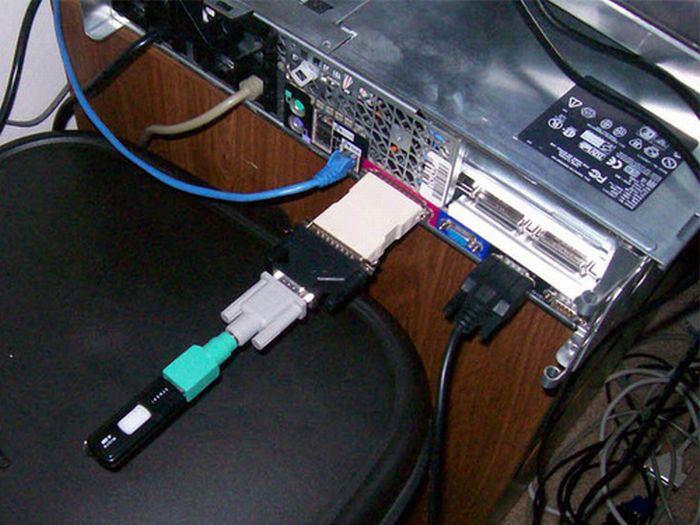

I immediately thought of this when I saw this thread.
that little usb stick could easily have more storage on it that that old PC there...
