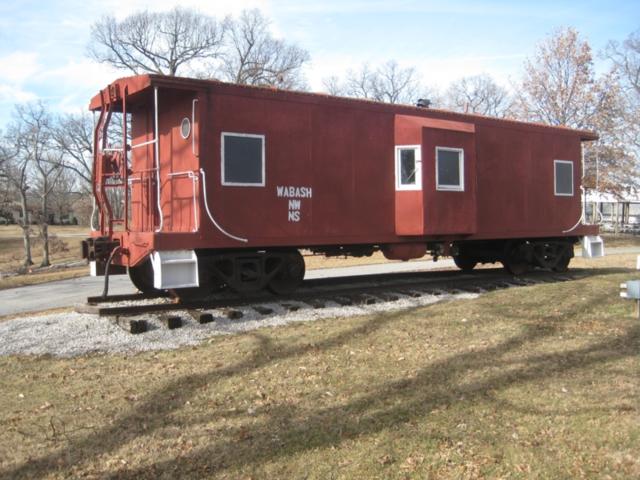

Southern Railway's caboose X423 currently resides in the city park of Brunswick, Missouri. The caboose is lettered for NS, N&W, and Wabash. Brunswick received the caboose from the Norfolk Southern. The city requested the caboose to honor its heritage with the Wabash and successor railroads. I have attached pictures showing the condition of the caboose.

File comment: Caboose X423 - Full photo

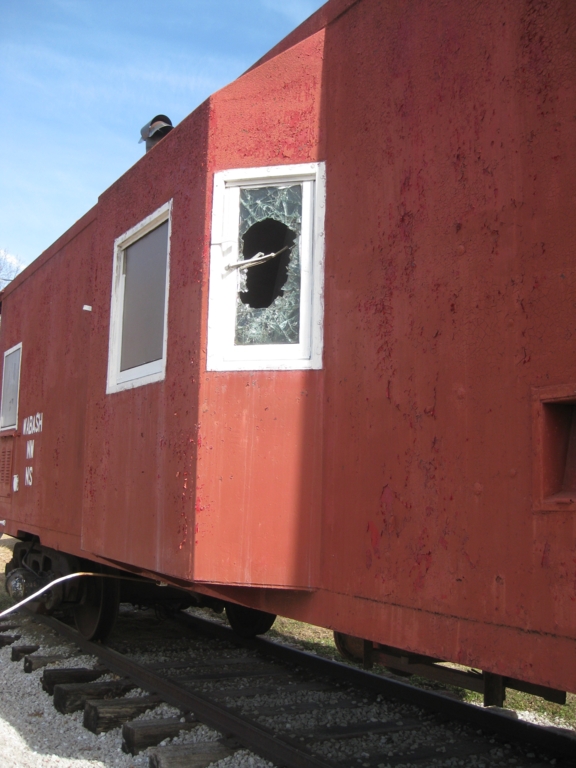

File comment: Caboose X423 - Broken window
20140125_Photo_Brunswick_CabooseX423_BrokenWindow.jpg [ 276.74 KiB | Viewed 9794 times ]

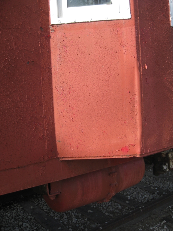

File comment: Caboose X423 - Peeling paint
20140125_Photo_Brunswick_CabooseX423_PeelingPaint.jpg [ 293.91 KiB | Viewed 9794 times ]

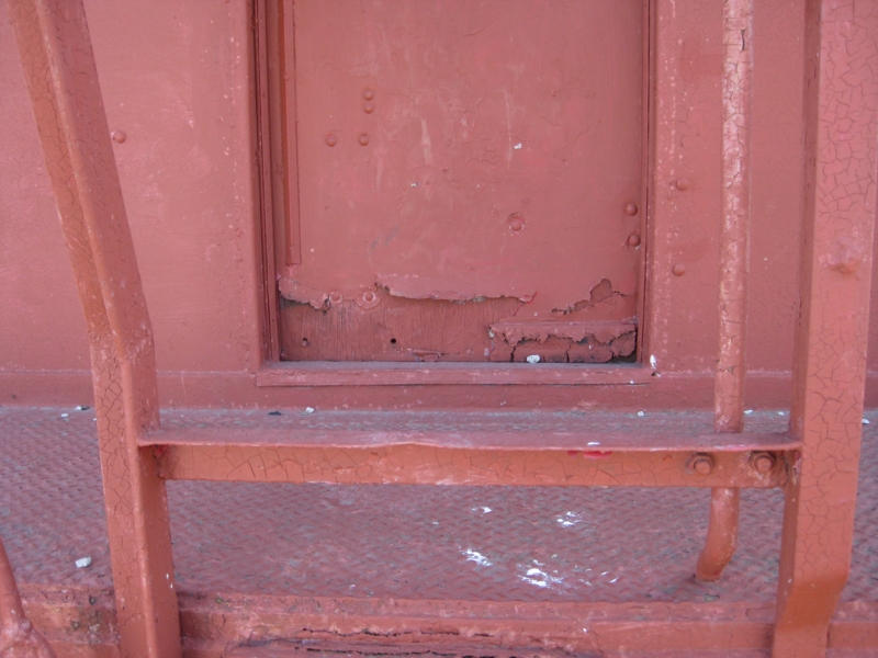

File comment: Caboose X423 - Door needing repair
20140125_Photo_Brunswick_CabooseX423_DoorNeedingRepair.jpg [ 303.33 KiB | Viewed 9792 times ]

In general terms, anything left unsecured and outdoors will need to be made as robust as possible to last as long as possible with minimal maintenance before another complete overhaul is necessary........
So, you will want to remove the paint layers down to bare metal or as close as possible, then using a high quality industrial or automotive grade of paint, and a matched paint system, prep and prime and cover during good weather exactly according to the paint manufacturers specifications. Home Depot paint won't give you a job that will get you through a couple years without failing. If you can install glazing that rocks bounce off rather than penetrate it will save you a lot of hassle over the years....especially if you do not permit things like rocks, sticks and other things vandals like to use from accumulating nearby. Constant lighting during the night, and being located in plain view in a frequented area also helps.
The door is a composite of metal sheathed plywood. You can probably remove the worst of the bad metal, kill the rust with a good brand of phosphoric rust converter on what's left, and install a new piece of sheet metal at the bottom, soldering the lap seam where it overlaps the existing.
Maintenance will make any finished product last longer. Keeping the roof leak free with elastomeric coatings, preventing people from climbing up on it, making sure the window sills and window frames stay watertight, and allowing for plenty of ventilation around and underneath where the floor meets the walls will help preserve your work and the caboose itself.
Don't skimp on prep or using the best quality paint systems and other products you can.....the few dollars saved now by going cheap will cost you much more when it fails sooner and needs to be done again than doing it right at what a good job costs in the first place.

The door is a "sandwich" of plywood and wood in between sheet steel. It may be as easy as doing partial steel replacement after using expoxy and other stabalizer.
The "quick and dirty" window replacement would involve plexiglass or Lexan. However, those tend to fog up with age and UV exposure.

So what is a good, readily available, rock-bouncing glass product that could be used for window glazing?

Do you have a suggested source for FRA glazing? Also, the town has the following options for painting and lettering:
1. Southern Railway colors, logo, and number as shown on http://rrpicturearchives.net/showPicture.aspx?id=3284641.
2. Wabash colors and logo but no number as shown on http://www.pbase.com/sanoyes/image/79194110 or http://www.rrpicturearchives.net/showPicture.aspx?id=436769.
3. Norfolk & Western colors and logo but no number such as N&W 557519 shown on http://www.krunk.org/~joeshaw/pics/nw/caboose/.
4. Norfolk Southern colors and logo but no number such as NS 555553 or 555682 shown on http://www.krunk.org/~joeshaw/pics/ns/caboose/
Option 1 is probably not viable since the town is located along the former Wabash mainline to Kansas City. The Southern Railway history of the caboose could be accommodated by a plaque. My preference would be option 4. What are your thoughts or recommendations? Thanks!
Sincerely,
Gary Drag
