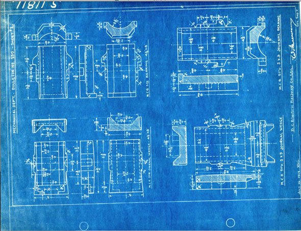

Maybe help you? see attached. If this looks promising send an e-mail address and i will send a large attachment.

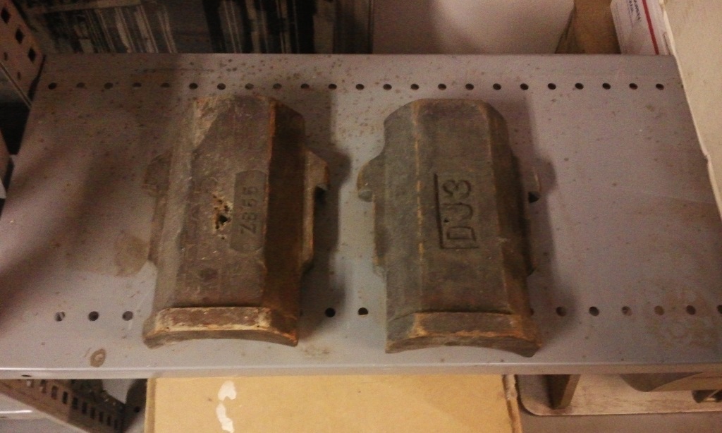

I have four brand new 5x9 bearings that I have no use for. If interested in them please PM me. I also have two wooden patterns for 4 1/4" x 8" journal brasses. They are also available.
