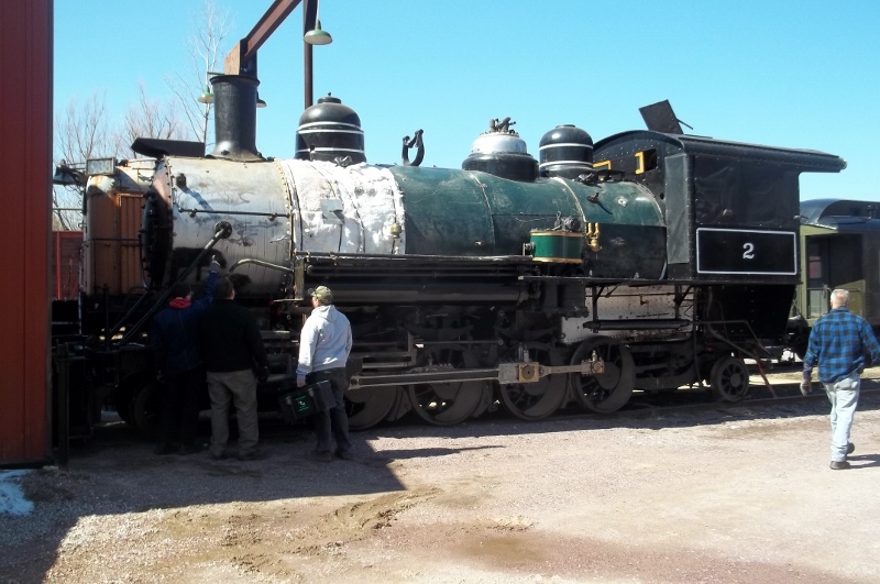

Picture of the cab installed, 3/28/15.

 Post subject: Re: News from Mid-Continent on the Saganiaw Timber #2
PostPosted: Tue Mar 31, 2015 1:17 pm
Posts: 966
I like it when big pieces go back on. Nice photo's guys and good job too. Was kind of hoping the jacketing was done so I don't have to help with that last course. OF course that should be the easiest section to do, as the second to last wasn't that bad. Will see if I can make it down sometime this week. Meetings and last minute call ups are keeping me close to home.
How are we coming on the mud ring bearing block revision? Would be nice to get the communist side plates and brake rigging back together again. I thank you guys for stepping up and pushing this project forward. It needed a couple of extra bodies and a goal deadline to fire up. This is how to get things done. It is how the museum got to where it got. Membership pulling together is a great concept and it works! You guys rock.
Cheers, John.
